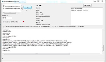

It appears to be steady red, but the data scrolls by very quickly.
MikeyM
try the download again
and this time it will stay on if UDP data arrives
Brian
Ok new update the red light is on steady. I tried unchecking “use UDP” to see if that made a difference, but it didn’t. I also shut down WD and restarted it with the same result - red light continually ON.

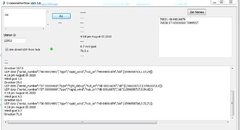

Ok I did so many test with UDP checked and unchecked and with the HUB connected and disconnected that I’ve totally confused myself. It’s late here and maybe with a clearer mind in the morning I can give you some better feedback. It appears if I uncheck UDP the LED stays GREEN, but if I restart “cronweatherflow” with UDP unchecked the LED is RED and will go to GREEN when I check UDP, but only if I restart “cronweatherflow”. If I don’t restart “cronweatherflow” the LED is always GREEN whether UDP is checked or unchecked.
Hope that makes sense. I’ll post some screenshots in the morning.

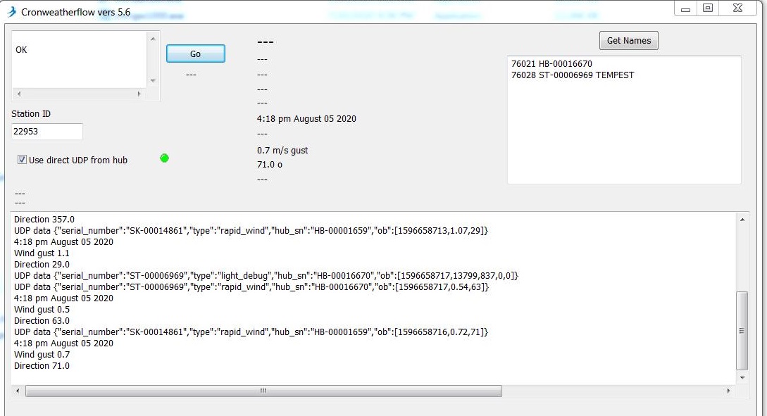

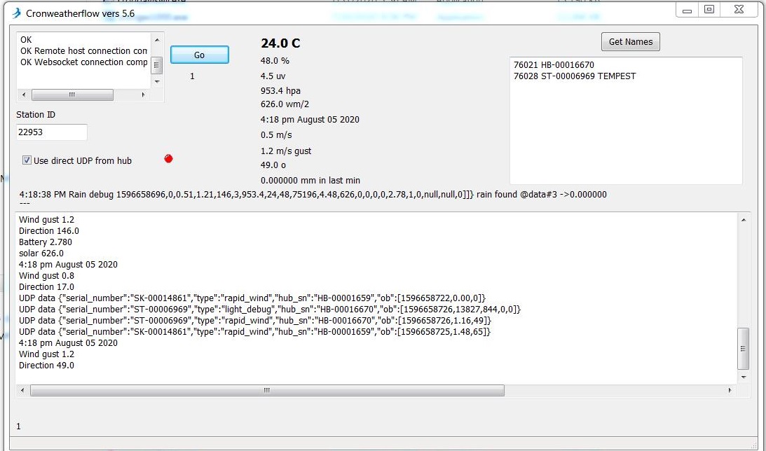

It stay RED when I see the:
“OK Remote host connection complete. 0”
“OK Websocket connection complete. 0”
It’s GREEN when I see this at the Start of “cronweatherflow”
“OK”
OK LED GREEN during startup of “cronweatherflow”
OK Remote host connection complete. 0 LED RED after “cronweatherflow” starts showing data.
OK Websocket connection complete. 0 Continuous RED after I receive this.
Maybe I can do a video of “cronweatherflow” starting up and email it to you.
