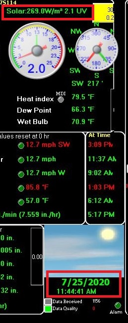

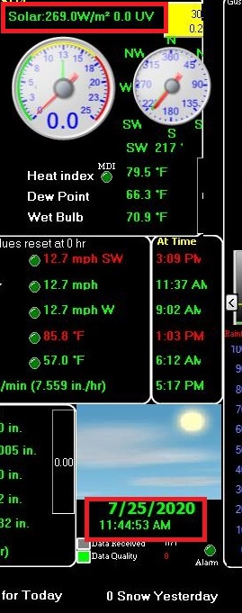

The correct WeatherFlow UV will appear on the main screen once every 1 minute for 5 secs and then shows 0.0 UV for approximately 55 sec and then the correct UV will appear for 5 secs again. Any idea why?

Brian it’s back doing exactly the same thing on both computers, running version 110 and one running 114. The correct UV shows up for 5 secs and then shows 0.0 and 55 secs later the correct UV shows for 5 sec again.

Solar showing in WD was 204 w/m2 and UV fluctuated between 1.8 and 0.0
Tempest station 22953 was showing 204 w/m2 and 1.8 UV
