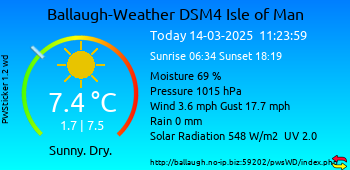

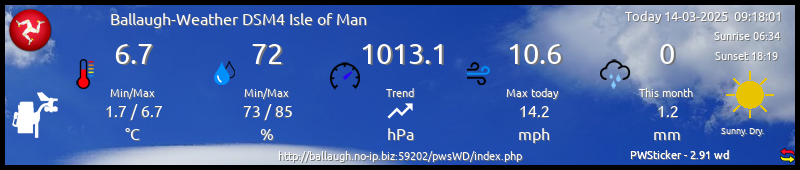

tried this again tonight after some months https://www.hc-iom.co.uk/stickersPWS/stickerdigit.php worked first go after reload on to server but now all i get is after a while is error 500 and this from server log
[Tue Apr 23 22:09:39.874690 2024] [fcgid:warn] [pid 80836] [client 92.39.196.63:42451] mod_fcgid: read data timeout in 60 seconds
[Tue Apr 23 22:09:39.874731 2024] [core:error] [pid 80836] [client 92.39.196.63:42451] End of script output before headers: php82-cgi
appears to do the same on all 3
does the same on local server but no logs i can see, but appears to shoe compact ok stickercompact.php (350Ɨ170) (ballaugh.no-ip.biz)
undated to latest version as well
both servers are running versions of 8.2 php

Ok that got my local working http://ballaugh.no-ip.biz:59202/stickersPWS/stickerdigit.php
Needs a few tweaks but will sort this evening once laptop is wound up and then sort main site
Thanks Wim
updated the flag but also had to update file permissions to 755 for the folder and contents
first run still gives internal server error but now if the page is refreshed after the error shows the sticker shows up
the error log is still showing the same error as posted before
