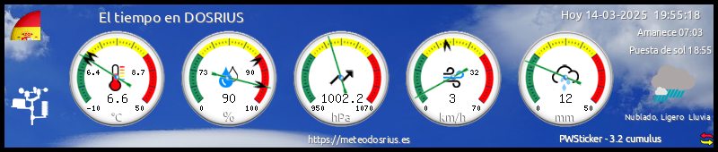

It does not work for me. I don’t know why.
Any suggestions?
Hi, do you have something into your error_log file?
This one works
These do not work
I can’t find any “error_log” file in the stickersPWS folder.
When I run it, it just says that it can’t display the image because it contains errors.
I did a fresh install using PHP 8.2
