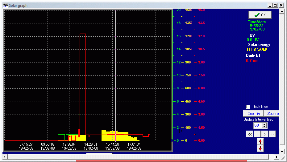

At the moment it shows 0
If I shine a torch at it I get a reading.
Please see Pictures.

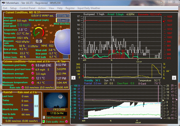

Hi All
Back Again.
I think there may be progress, but may need tweaking.

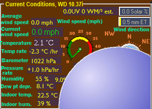

One small problem I created when redesigning my layout, is the wind direction disc grew rather than shrank when I tried to make it smaller.
Can it be shrunk?
Wood Ant
Main screen
right mouse click on that wind direction dial to select to make smaller

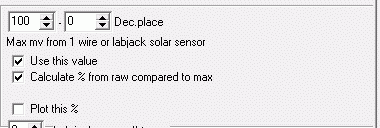

in the solar setup, see the 1 wire/labjack tab
Hi Windy,
Do I need to change this setting?
Also its just got bigger ans would not shrink ?
Regards Wood Ant
try restarting WD before it explodes!
I have a number of times but will not reduce in size.
And it exploded.
Is there a minimum size?
Have also bee look through posts on hints on the solar setup
Wood Ant, there are settings in the registry for that blue circle, i will try and find the specific item again and post how to fix it.
Graeme
OK - I have found it...
Shut WD down. You may have to use Exit - Save anyway to save some changes you have made already.
Run - Regedit
HKEY_CURRENT-USER
wdisplayftp.ini
…Main screen custom
…abgeardial x … 76
…abgeardial xx … 328
…abgeardial y … 76
…abgeardial yy … 328
Then close regedit and restart WD.
Now, the 76 and 76 lines are the starting point of the top left corner i think, Windy indicates they are the size of it and the 328 are the far corner of a square surrounding the circle. try working with those anyway - i may be wrong but that’s what you have to work with to fix it.
Remember - these changes don’t take effect until WD starts again. patience!
Good luck…
Graeme
If it is the right size, then just use Edit Main Screen and the SHIFT key to move it to where it should be rather than trying with the numbers.
Cheers
in the registry:
wdisplayftp.ini (search for that with regedit.exe)
[main screen custom]
abgeardial x=
abgeardial y=
make those smaller (or delete altogether)
and then restart wd
:laughing6:
[wipes coffee spray off the screen]
Thanks Windy it’s asI want it.
Regards Wood Ant
