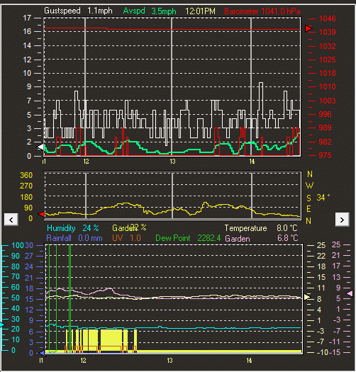

also strange things have happened to my main screen.
If you can help I would be gratefull.
Image attached
Regard Wood And
Hi Wood And

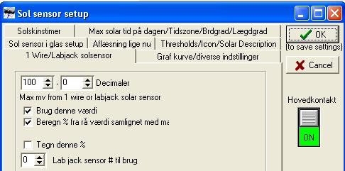

Here is some pics of my solar settings.
Its okay the main screen changed too - you can move and resize the different elements by choosing:
“Setup > Advanced/misc/WD setup” - then tick “Move/resize objects” under “Main Window customise”
Hope this helps.
Henrik

My main screen
Hi Henrik,
Thank you for taking the time to help me.
I used your settings to set up WD. And I still do not think I am getting any data from the Solar Sensor.
The cable I am using is (Standard CAT5e RJ45) is this OK, or do I need to modify it?
My sensor was purchase already boxed, do I need to make the electronic modifications that were suggested in your link for it to work?
I have included images of the Com Port settings in case I have made any errors.
Image of main screen in next post
Thanks for your Help
Wood Ant
Main Screen and graph settings
Wood Ant

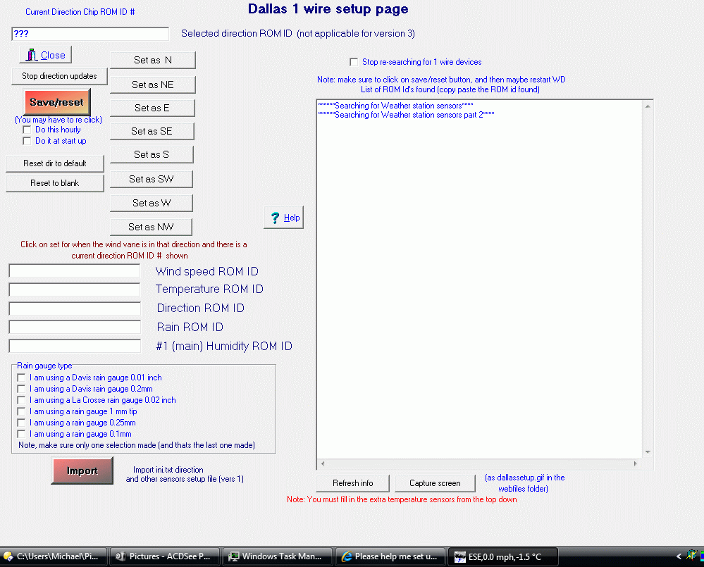

What do you have in Control Panel > Dallas 1-Wire Setup > Solar Setup?
You should have the ROM I/D of the solar sensor in the top area and “Use this as my solar sensor” ticked, is this the case?
If not, are you picking up the ROM I/D of the solar sensor in the Dallas 1-Wire Setup main window, click the Reset/Save button and see what comes up in the righthand window.
Hi again
See attached pick fo my setup in Dallas 1-Wire Setup.
Another pic of Dallas 1-Wire settings
I have attached my solarsensor thru Standard CAT5e RJ45.
Henrik

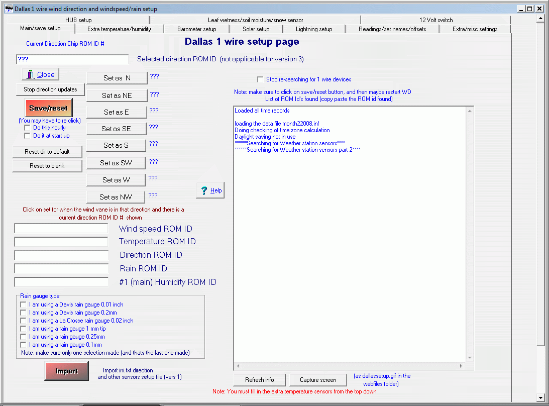

Hi Henrik,
Thanks for your time and the Pictures. I am beginning to fear that my sensor is not working.
Please see images. One before and after reset.
I found a utility with the drivers that found the adapter on com one so I changed it and re started WD
And are there still things I need to set up? for example in my comport settings?
Are my drivers the wrong ones (Dallas Semiconductor Maxim 6.0.1.0)
Which Drivers do you use?
Regard Wood Ant
After reset
Do you have OneWireViewer on your PC, it’ll be in the Maxim program file?
If so then activate this and see if there are two sensors detected, the adaptor and the solar. If these are both there then the 1-Wire is working and we can go from there.

Could I be getting somewhere?
Still no reading though
Please see pictures in this & next post
Wood Ant
WD Solar
Good, the OneWireViewer is picking up the solar & adaptor so the system is working.
Looking at the second post with the ROM I/D of the solar sensor, is that also in the right-hand window of the main Dallas page in WD?
If so then it should be showing on you graphs and in the extra sensor pages in WD.
