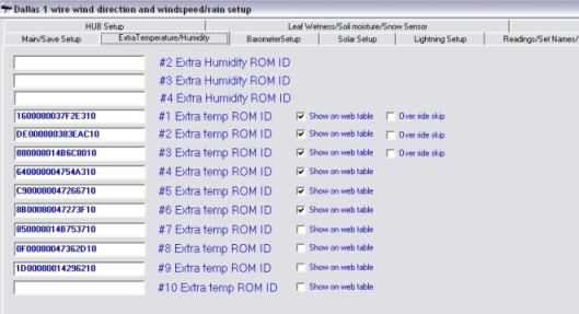

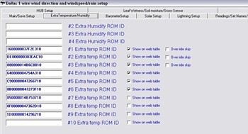

TokKiwi: I can’t delete the ROM ID out of the humidity box or any other box as it only appears as
Humidity or barometer i-button found, ID CB000000B6503D26
5th Humidity i-button allocated to, ID CB000000B6503D26
on the main/save setup tab which you can’t change or delete - see attached screenshots of the main/save tab and the extra temperature/humidity tab. I’ve saved using the save/reset button and restarted the program but to no avail

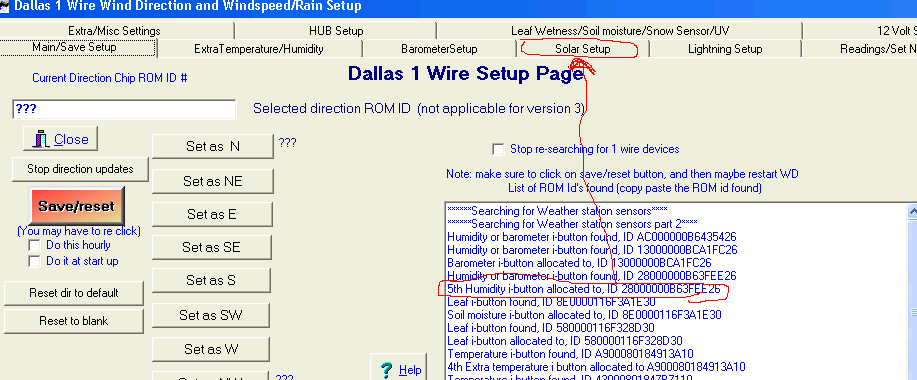

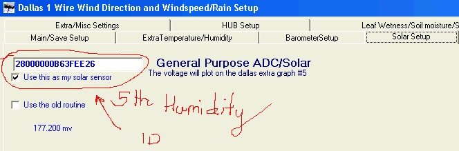

hi
5th humidity is correct this is the solar sensor
you need to copy the ID rom to the solaar settings if you look at the images below these are my settings
you will see in the first image 5th humidity id rom number, highlight the number
then copy the number into the solar sensor id rom please see image below
