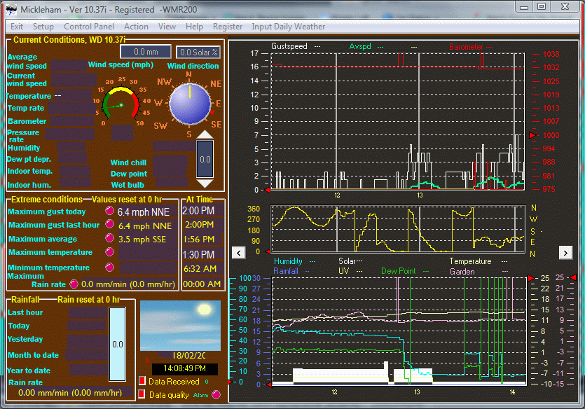

Please have look at the main screen capture, I did not start WD until after 12:20, but there has been something plotted at 11:30.
So I think it may never have been working.
So its back to the drivers, are you people all using the the same as I am ?

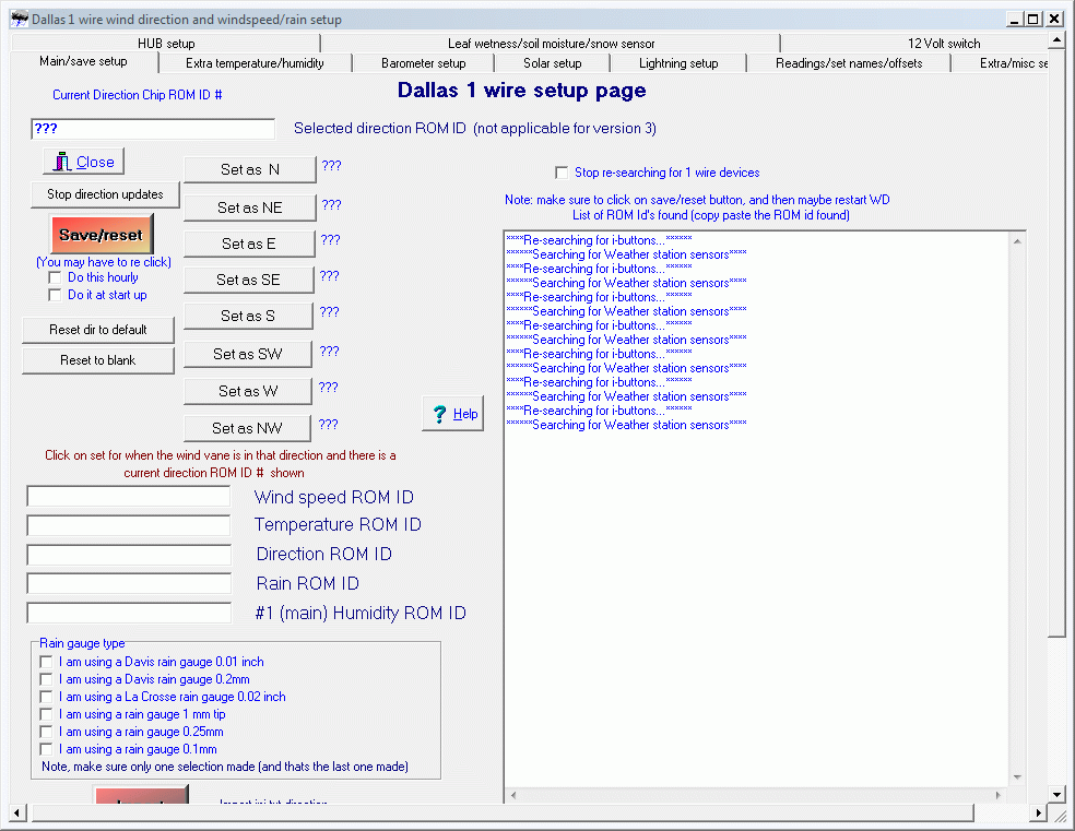

Don’t get bogged down with what’s showing on the graphs just now, is there anything from the solar sensor in the Dallas setup window?

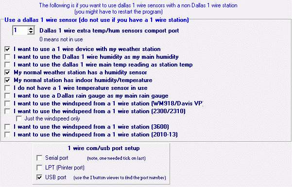

Have you tried the COM Port Number set to 4 and the “Dallas 1-Wire / with station settings” set to 1, then click on the Save/Reset button and restart WD?

Go into WD > COM Port and untick that you want to use a 1-Wire device with your WS.

Then fire up WD and reselect the “I want to use a 1-Wire device…”, go into the Dallas Setup screen and click the Save/Reset button and see if there is anything detected.

We moved forward and this is now scean in the Dalas righthand window.
**Searching for Weather station sensors
Humidity i-button found, ID 67000000B6489B26
What should I do next ?
Thanks Wood Ant

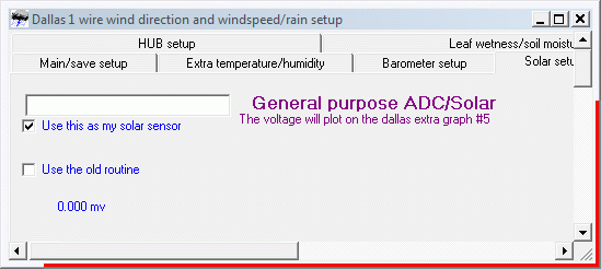

now make sure that the solar ROM id is set to
67000000B6489B26
and you have ticked to use that as solar
and then click on save/reset
