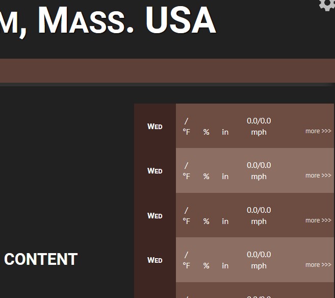

my next question now is…is the worldweatheronline API key free or do I need a subscription to get one? I saw it was free on their site and also wanted to ask what format do I choose when trying to get my api key from them? the choices are Output format as JSON, TAB or XML
I believe I need this Api key in order for my forecast section to work as it is blank now…see attachment below
The worldweatheronline site to me seems very hard to navigate and struggling to figure out where to get the API free key so my forecast cestion works.

hi…the key should be already available…search for get new api key or something like that on the web page
replace BRNO with your city :wink:
cheers
Thanks for reply Carl,
Yes your key should be in your wwo profile. And yes you only need the free version. For the city just put name of yours and if it doesn’t find it the script will use your coordinates.
Homepage forecast however is from aeris, another free forecast provider. I am also now working on a version which uses yahoo forecast where no registration is necessary

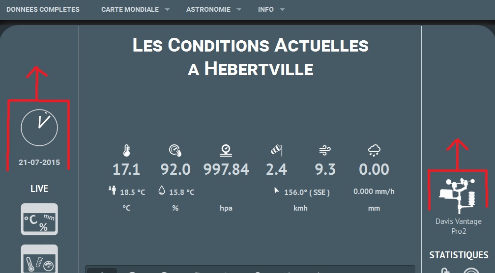

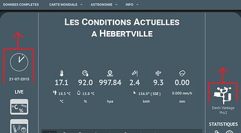

Hi…ive been struggling with this for a bit now and just cant point where to put the thing that will move upwards the side colums on the /page/station/index.php like on the attached image :wink:
ive tried numerous things like: align top ,remove br, ect…and it looks like its related to livedata.php cuz,before that page appears,both side colums are at the top but move down after :roll:
