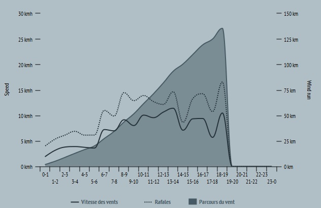

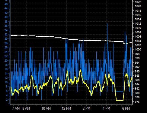

attached are 2 todays wind graphs…im trying to provide clues as much as i can and think of… :?
Hm, this however could still be the same problem we were already discussing, the max gust occurred in between two intervals when the data was logged.
But it would then be interesting to know what parameter for gust (which tag) does WD send to WU, because you said that one was correct. And if I understand it correctly, WD logs are also wrong?
