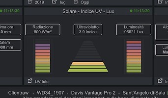

Hello,
I noticed this problem with the UV block, with the translation coming out of the rectangle, can something be done?
Thank you
site: https://stazione.meteosantangelo.it/pws07/
Although the problems are minimized in this version, there will always be translation texts which do not fit. Weather-texts are often more compact in English then in other languages. In this block the room for that text is nearly at its maximum.
If you do not want to change the php script yourself, you should change the translated text and remove the word solare
It is for the visitor clear what the values are anyway.
