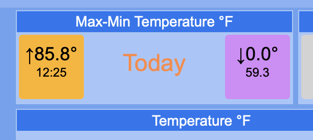

my minimum temp block, the little one at the top, seems to have the time and temp reversed. Checked the raw data and it’s reversed there as well… so is it my raw data file that’s got the order incorrect? or something else?
http://www.tuley.online/pwsWD2/index.php
I think there is a far bigger problem.
But first thanks for bringing this to my attention. I hope we can find a solution quickly.
realtime.txt is defined at: https://cumuluswiki.wxforum.net/a/Realtime.txt
The dates are in a metric order d/m/y and 24 hour times.
The separation between fields is the space character.
Your realtime file
=> http://www.tuley.online/pwsWD2/w34_module_test.php select …/pwsWD/WCT_Realtime.txt in the left bottom selector and click "List contents
09/07/19 13:37:17 87.5 11 26.5 1.0 0 187 0.00 0.00 29.86 187 0 MPH

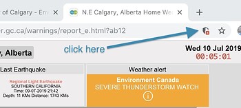

using Environment Canada. When I click on the warning I get a blank screen
This is caused by a https page (yours) loading a http page (Weather Alerts for: City of Calgary - Environment Canada).
The browser needs to get a “do-it” , see attached screenshot.
I will try to find out if there is a script error or otherwise why EC gives us a link with http as the same page is available as https also.
The EC script is loaded from https, but the links in the returned xml are still http.
I changed the script to translate the http link to https, so it should work OK now.

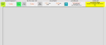

Problem: my July version page (url as left but /pwsnew/) layout is corrupted, but it was OK when I went to bed last night! What should I check?
It is easier to test with a more simple page: http://swanston.maui.co.uk/pwsnew/index.php?frame=test_image
It seems that you tried to move the alert-block to position 4 and in that process both the alert-block and the garden block are now in the same position. There is one missing?
In these cases I need access to the easyweather settings or even better an ftp password/userid.
Thanks for looking, Wim. I did indeed move the alert block, but it has worked perfectly for the last two days. There is now an alert for the first time, would that change anything?
PM on its way.
EDIT: I see it works OK if the alerts are put back to position 5.
Yes, but I changed the script so it can cope with it.
position 1-4 are included to speed up loading of the page.
The alertsblock is normally loaded last via jquery_GET in a separate PHP process as it can take considarable time to get the alarms.
There are 4 blocks + 1 special for the alerts. You can put the alerts in another place in w34_index2.php
