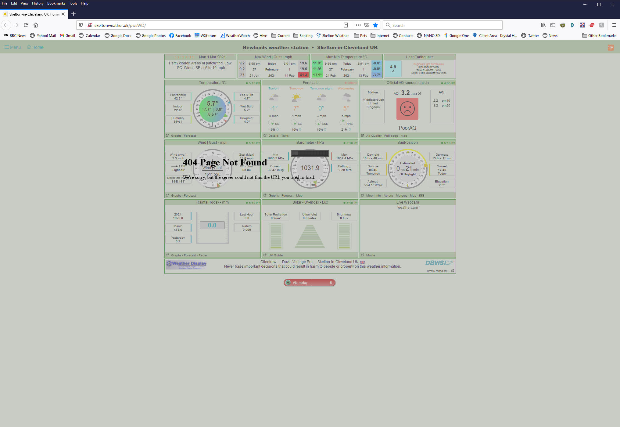

Have a small problem, getting a error message when trying to run the movie (haven’t setup the still image yet)
PWS_blocks.zip (4.1 KB)
webfilm_popup.zip (808 Bytes)
[s]This is the link which is used
http://skeltonweather.uk/pwsWD/_my_settings/webfile_popup.php?script=webcam_c_block.php
This is the error
404 Page Not Found
We’re sorry, but the server could not find the URL you tried to load.
So the script could not be located in the _my_settings/ folder.
Did you
  1. unzip the script and
  2. put it in your _my_settings/ folder ?
Wim[/s]
There was a typo in my previous post.
All is working now.

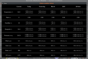

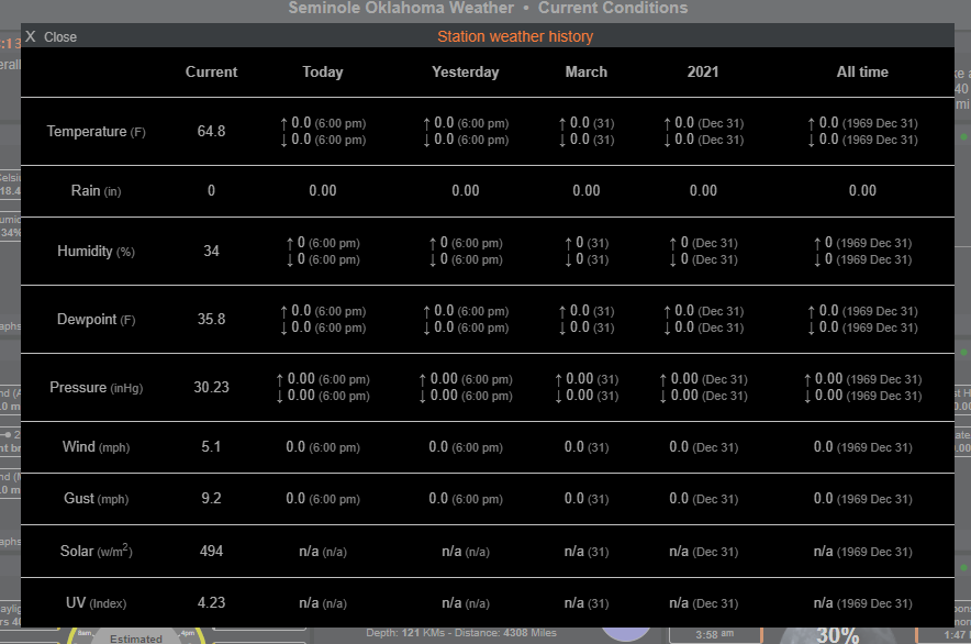

I have just finished my installation of the PWS_Dashboard and most everything seems to be working at http://thenoleweather.online/. However I cannot get data to pull for the Max Wind Gust for today and the history and the min max temperature and its history and the entire history for my station. I am using Weather Underground for this. I dont know what I am doing that is not pulling this information. I am including screen shots of what I am talking about.
have you setup your cronjobs
No how do you go about doing this?
Go to support/download page PWS_Dashboard start and see under Documentation.
You are using WU for graphs, which are working OK, but you need the cron job for History and max-min.

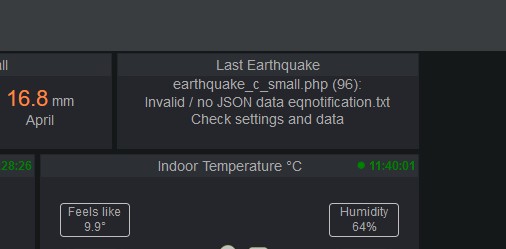

I have just updated my files via easyweather and uploaded them to the site and now, unfortunately, now the earthquake block is not working :(, can you point me in the right direction to fix it please?
Thanks again, http://geashillweatherservice.duckdns.org:8085/pwsWD/index.php
Keith
I too have an empty eqnotification.txt (from https://pwsdashboard.be/feeds).
Oh! OK, then it’s not just me :lol:
