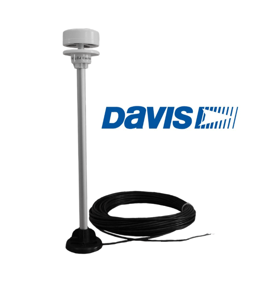

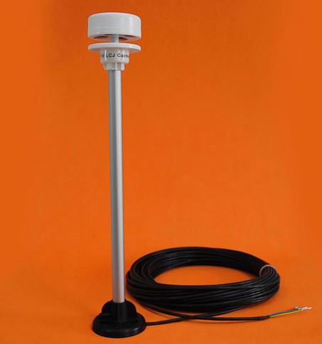

Im waiting for price feedback on the Darrera, the LCJ CAPTEURS, SONIC-ANEMO-DVC price: 679 Euros ex VAT
Shipment cost : 42 Euros ex VAT
But i tink the sensor from Darrera is the one to choos, depend on price #-o

http://www.lcjcapteurs.com/product/self-powered-ultrasonic-wind-sensor/?lang=en
Hi VENTS and thanks for input.
Have been in contact with lcj supplier some weeks ago reg SONIC-ANEMO-DVC (down in this thred) and its not suitable for my area and needs.
Have max 40 m/s and no heating possible.
