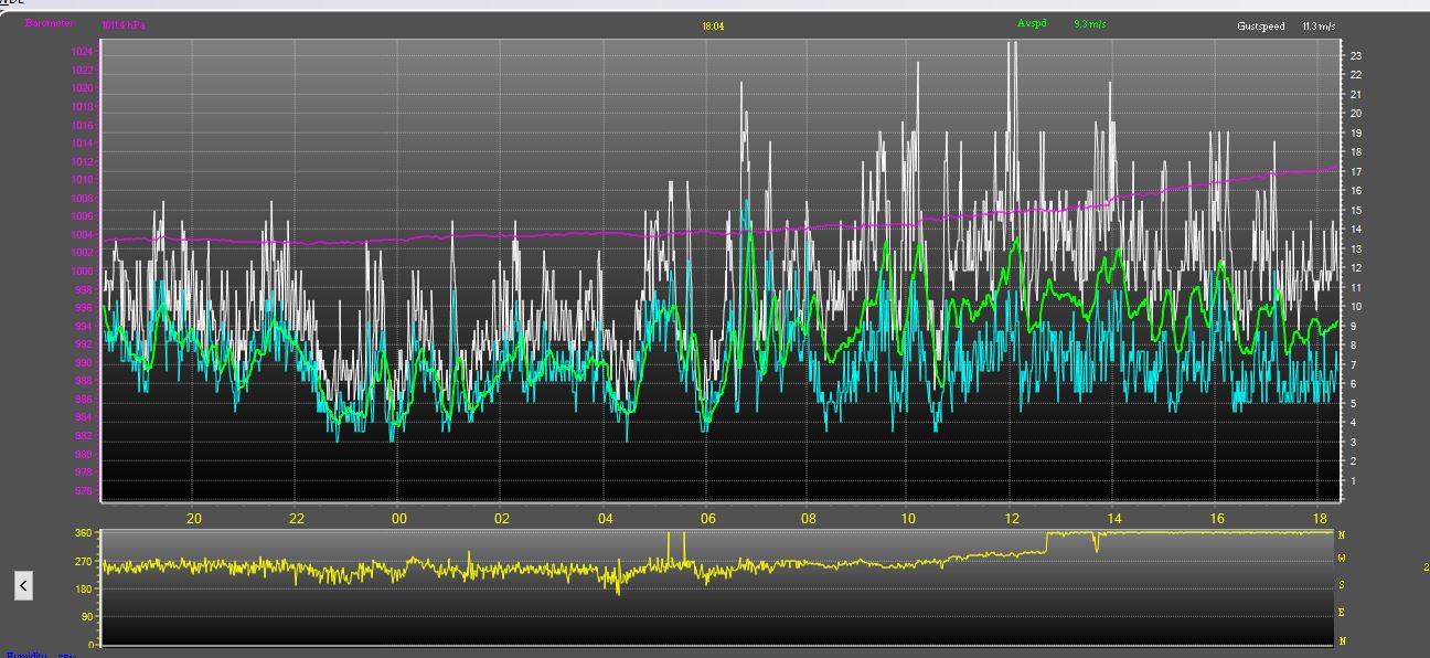

Davis wind sensor direction broken for the 4x times in 18 months.
hello.
Just happend again today.
Has anyone experiensed this issue??, is the davis vantage pro2 wind direction sensor this bad. #-o
After some wind from 20 m/s to 41 m/s xx of times over a period, the the wind direction suddenly just parked it self to the north. Finito.
nothing is visualy broken on the wind sensor.
This is the 4 time in 18 months, just as long as i hhave been moving up hill from centrum.

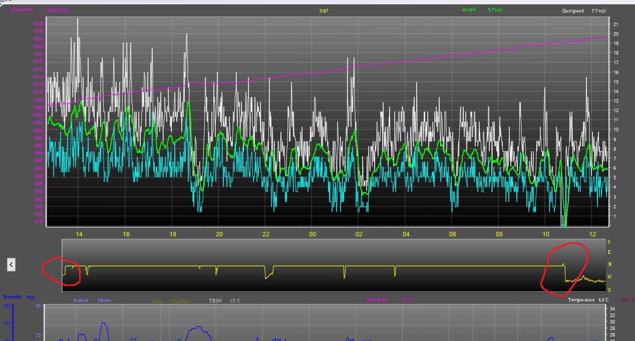

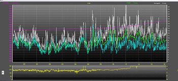

See graph photo when defect occurs, and also placement of station.
Even my netatmo wind sensor mounted in same place overlive the davis!!!
Any ideas?? What to doooooo!!!

Thats correct Brian, showing the incorrect north reading on the consoles too, steady always north, and wind wain moves around normaly.
Seems like the direction potensiometer cant stand the load under high wind force, if some turbulence (vain moves just some cm quickly from side to side).
Else i dont understand way this is happening, but always under high wind from 20m/s and up.

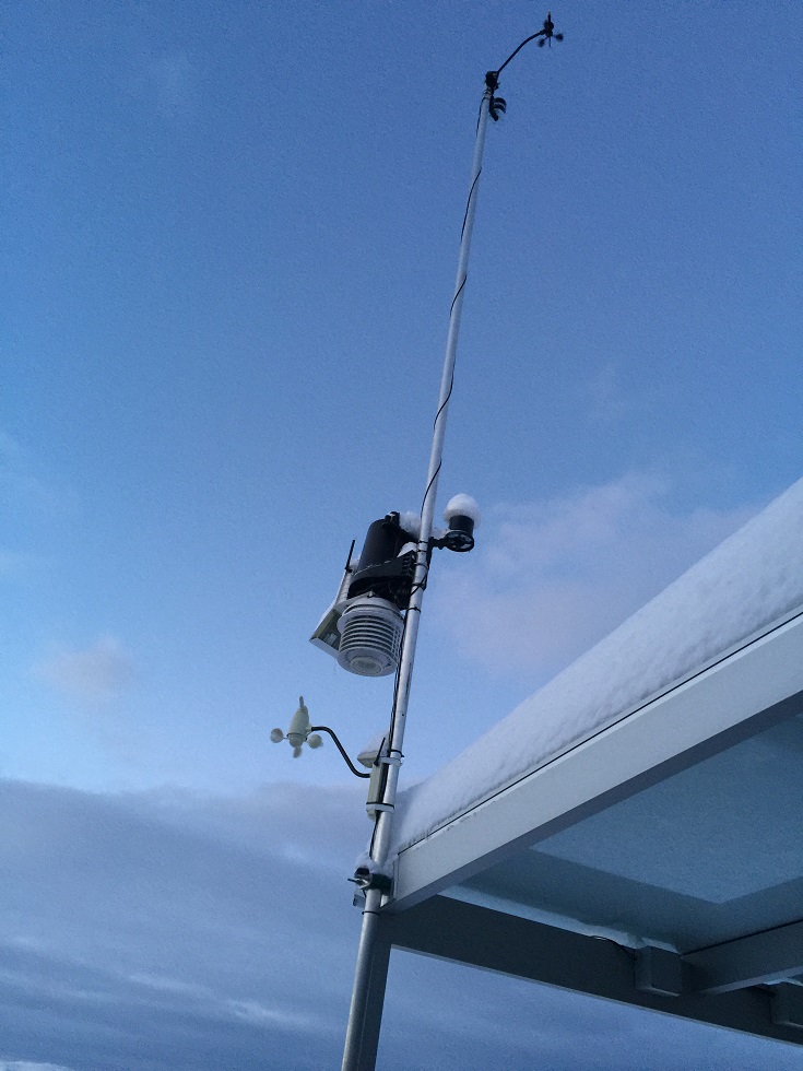

Possible you or all can upload photos of placement of your wind sensor? place its mounted/standing compare to surroundings??
Mine as you se on photo in this thred is 1,8 m over roof top, up hill, nothing around is higher except mother earth.
Just curious compare to my place/surroundings. obviously this defect has something to do with quick gust winds.
The funny thing is netatmo wind sensor seems to like it here, but had to make some air holes for water condensation inside, in the lower/upper part :smiley:
The drum of cable you see on roof tilings is for rain bucket heater.
maybe the netatmo sensor is causing turbulance ?
it seems to be direct up wind?
hard to tell on angles from photo

Davis lower part is mounted horizontally some cm clear/higher then the netatmo.
also regard to high wind direction, the netatmo is not in the path, but near yes.
House roofs are flying when wind is coming from the bridge in the horizon you see on photo, southwest.
Little bit better photo here.
20 ft above roof, roughly 33ft off the ground.
Nice photo:-) @looney2ns
How is it to do service when so long? like with me, need to change wind sensor 3x time ayear #-o
I unhook the three guy wires, take out a bolt on one leg of the tripod, and lay the entire setup down on the left portion of the roof. The other two legs act as a hinge.
