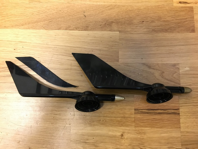

Now i have cut of aprox 40% of the wind vane tail to 35 k/grams . See photo.
Also grinded the bronze end down to get weight balance correct.
I now this will affect quickness for change in wind direction in low wind conditions, but i think it will indicate good above 6-8 m/s anyway.
Also it will not “hopefully” turn the quick small movement side to side as much as the original one.
Will change the wind vane as soon as weather allow it today or tomorrow.

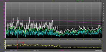

The modified vane has been in work since yesterday 18:25, see photo.
Surprisingly the modified vane seems for now even worse, but its also lighter (35 k/grams) then the original davis that is 43 k/grams.
Will see when more wind shows up.

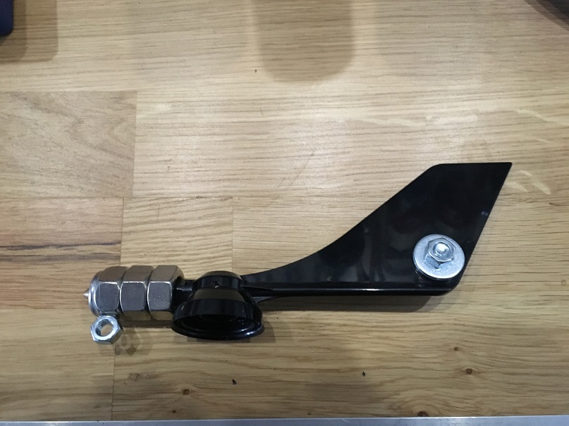

For testing i now have modified one original davis wind van, adding more mass, from original 43 k/grams to 174 k/grams. See photo.
A little bit bumpy look with nuts mounted on it due to the weight balance, but hope it does the job calming down the wind van quick small side to side movement.
Tested/compare to original wind vane in garage using air compressor, adding mass makes more “stability” on the van.
Original one was flexing quickly side to side, the more mass wind vane was calmer in the garage test.

The first test i did by cut of aprox 40% of wind van wing surface was 35 k/grams after modifying, and was looking worse then original reg small quick side to side movement.

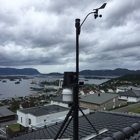

Any chance the issue is being caused by turbulence? Your pictures show a lot of roofs nearby that could be disturbing the natural wind flow. Just thinking out loud, maybe more height for the anemometer would provide some relief to the quick changes you’re graphing.
Thanks for input NorCal Dan.
as i mention further down in post: Mounting it higher then 2m from roof top is not easy on the roof tiles ether, if alu pipe is longer the pipe will flex in the wind… then need support wires aso… wife will kill me :roll:
Get it higher up is no option at present time.
Since im living in a long slope down to sea 146 m over sea level, lot of wind turbulence up the long slope, a lot of houses, to get free of turbulence i prob have to have a pipe 25 metres high.
See photo of old position on balcony, 7,5 meters- 2 meters over roof top.
This will be positioned left-down compare to present position at this time.
But of course swaying a lot, when the wind was over 40 m/s last winter, the alu pipe almost broke in two :wink: If to support this layout with wires, i have to connect wires at my neighbour house wall [-X and he will prob be werry happy :wink:

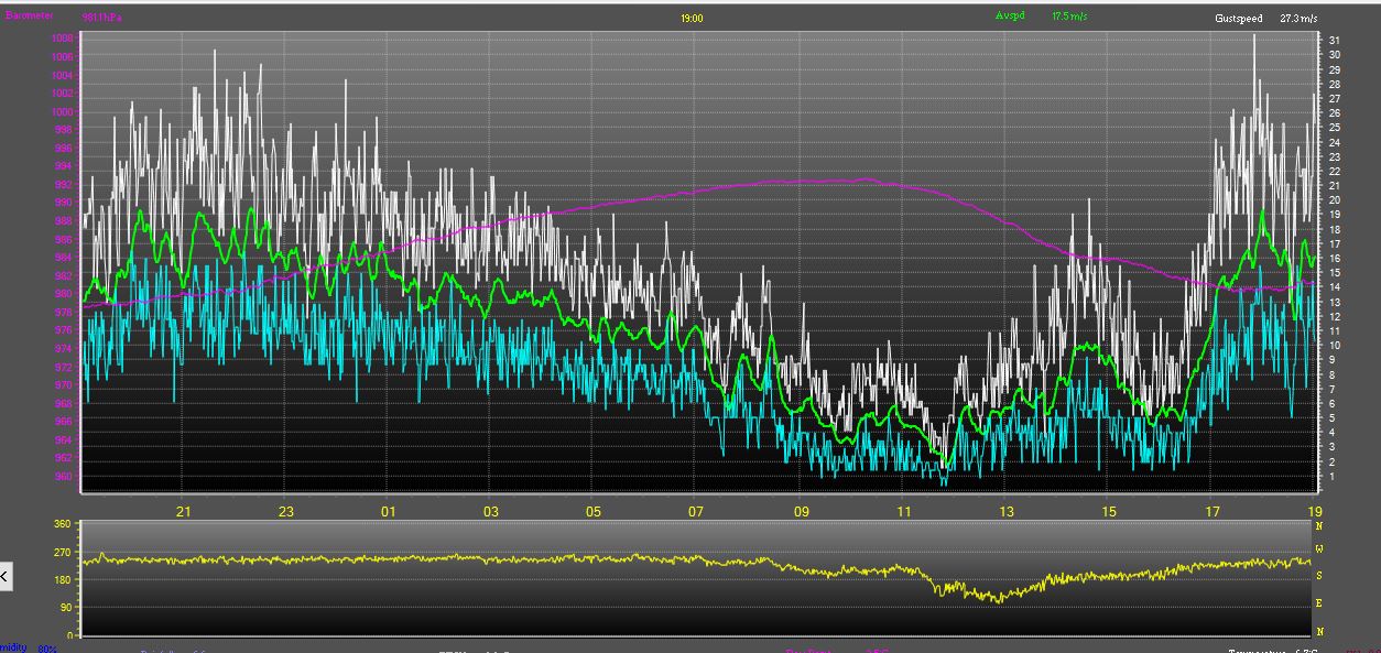

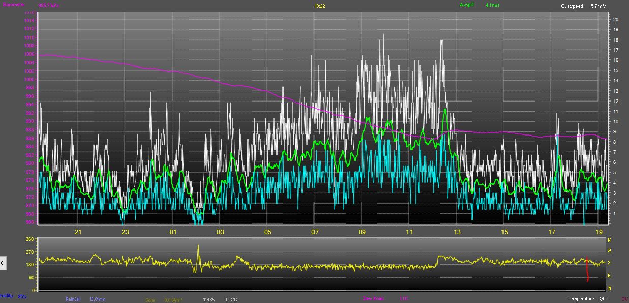

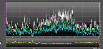

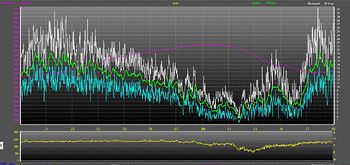

Looks like the side to side has gotten little better with more mass on the wind vane.
On photo- before red line is the cut of vane used 35 kgram, on red arrow side is the more mass vane in use 175 kgram.
Will run like this for a while, hope some more wind.
That does look a little better. Be interesting to see how it goes…
It would be difficult to mechanically damp it, you might do something magnetic but that would risk affecting the speed sensor. Averaging would be another solution but I don’t think the Davis has that possibility.

Here is graph photo since mounted yesterday, actually looking good so far i believe.
Seems like its wind from south that has most turbulence (all houses up hill), east-north almost strait line.
Need more wind to be sure.
