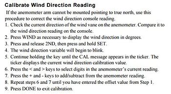

Does it have the possibility to correct the mag reading to true north, or do you have to do that in the Davis console?
Hi Niko.
Nothing to correct or adjust on sensor, the build in compass set it self.
Example: same compass as in a apple iphone so it will always be correct, i checked my darrera and it is spot on, compare to my old davis a few degrees.
But maybe in Davis console you can “miss” correct mag reading :wink:, i have never checked.
[quote author=Bj
Thanks Niko.
Nice to know difference around the world, i see in davis manual is possible to correct direction in any way you want if needed.
Any web sites showing the difference in magnetic vs thru north?
True, you can fix it in Davis, I wondered if it had any native correction facility.

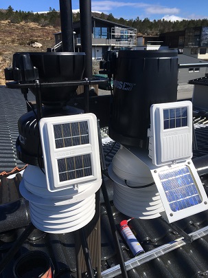

I see you have it onto the Davis FB feed with your tweet about using 2 anenometers side by side :slight_smile:
What can i say Brian… Im a Weather Nerd
some updates has been done, see photo.
So now i can compare darrera and orginal davis wind sensor :slight_smile: looks actually quite same, but nice with heater on the darrera.
Darrera wind:
Org davis wind:
low wind now, but nice to compare.
