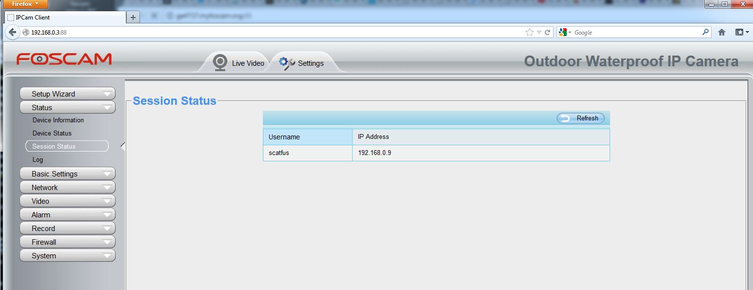

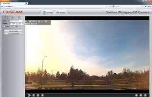

Please see the attached two screenshots from the Foscam IPCam Client that I use in an old version of Firefox. One is of live video from this camera, showing 192.168.0.3:88 and the other is from the Status tab, showing the camera’s IP address as 192.168.0.9.
I think I have tried all possible permutations with the cgi etc stuff by now in the Webcam Capture IP Setup and in a Chrome browser tab, but nothing has worked yet.
but that screen shot of your firefox browser only shows the IP cam client url
and not a url that is your local ip + cgi click+ username/pass etc (as per the link that hankster put up)
you need to try and get that type of url working in a browser window
