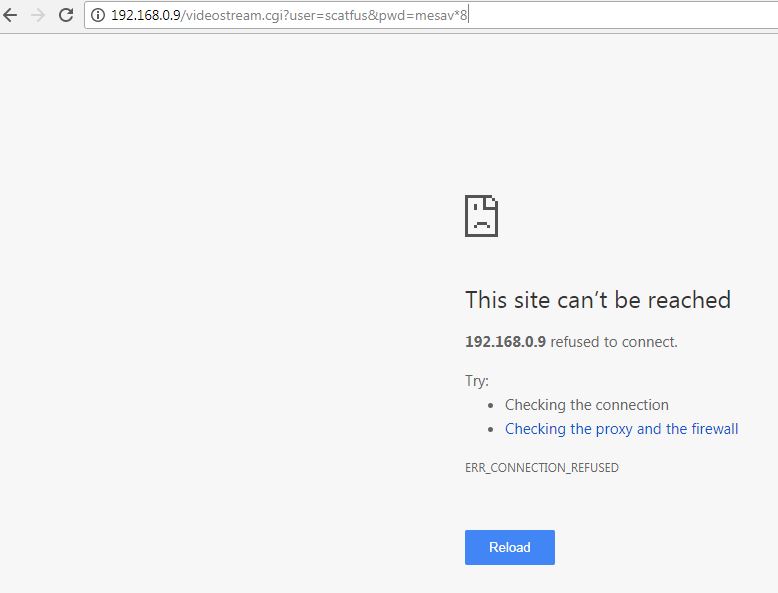

Thanks everyone for your time. Still not working after removing the brackets around username and password, screenshot attached.

you should be using this format
http://ip address/cgi-bin/CGIProxy.fcgi?cmd=snapPicture2&usr=[USERNAME]&pwd=[PASSWORD]
i.e the cgi-bin format
(remove the and set your user/pass and set your ip address etc)
What might also try is to put :88 after the IP address.

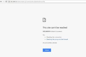

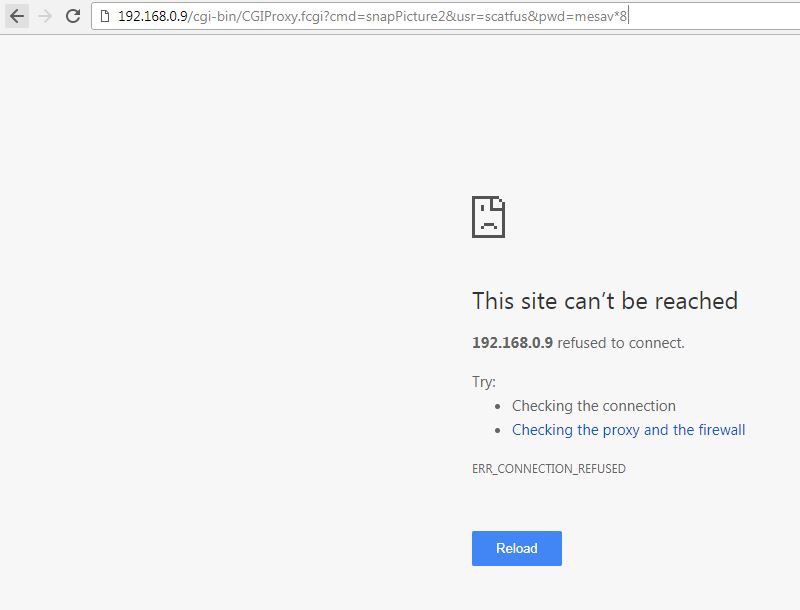

Thanks, but nope. See two screenshots attached. Gotta be something simple that I’m doing wrong. :hathat25:
Try the URLs I gave with the :88 in it.
OK, lets just see if you can connect with the camera at all. You should just be able to put the IP address in your browser and that should connect to your camera and get you to the login screen.
is the 192.168.09
correct
as the refuse to connect means that is not correct?
Well, been using the camera for three years, uploading to WU, I can see live vid on my pc with the Foscan IP Cam Client; sure I can connect to the camera. Just not by putting the IP address in a browser window. I’m not sure what login screen you are referring to.
I get the camera IP address from the Foscam IPCam Client software, as shown in the screenshot foscam status 2.JPG in Reply #18 of this thread. I’ve turned off firewall, antivirus; I don’t know what the refuse to connect means - that’s the $64,000,000 question.
Would there be an alternative method to determine the camera’s IP address besides the Foscam IPCam Client software?
it might show in your router config screen, connected clients
Did you use http://192.168.09:88 or https://192.168.09:443
According to the manual for your camera it says it needs the port number after the IP address. The manual is located at http://foscam.us/downloads/User%20Manual_FI9804P.pdf
If you can connect to your camera you will get the login screen that is on your camera where you can put in your username and password. The reason for doing it this way is find out if you can connect to your camera via an IP address. Once you know you can connect that way you can than try to figure out what commands are needed after the IP address to access the video stream or static jpg image.
