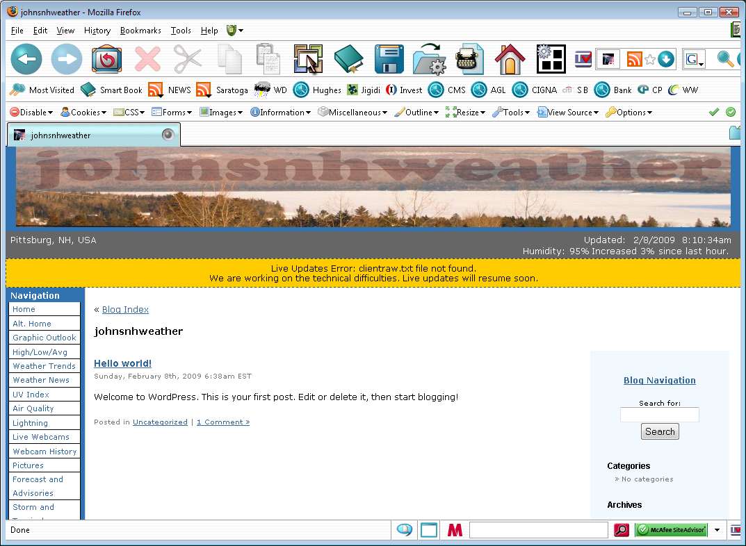

If you are using crtest.php (the Live Update Error script for WD):
Because your blog is in a different directory such as wxblog/, that makes the relative path for clientraw.txt incorrect.
To fix it, edit crtest.php
change:
$lu_crfile = ‘./clientraw.txt’; to full server path like this:
$lu_crfile = ‘/full/path/to/clientraw.txt’;
change “/full/path/to/” as needed
then comment out this line like this:
//if (isset($site[‘clientrawfile’])) {$lu_crfile = $SITE[‘clientrawfile’]; }
Then it should work on your main site and the blog

Hi Mike,
I have installed Wordpress for the first time and it’s working!!! The issue I am having is the page that comes up when I type http://www.johnsnhweather.com is messed up. I have attached a screen shot below. Any help would be appreciated.
John
Hi John,
Do you mean your clientraw.txt? It looks like it stopped uploading at 9:41, unless you are uploading it to a different directory? Check to be sure WD’s live ftp is still running. In the blog page itself it would look for clientraw in something similar to …/clientraw.txt.
Jack
That is because your blog is in a different directory wxblog/ and that makes the relative path for clientraw.txt incorrect
to fix it, edit crtest.php
change:
Then it should work on your main site and the blog.
I added this to the install instructions as step 7a :smiley:

Hi Jack,
No the rest of the website is working fine, it’s just the blog page that’s not working.
John
