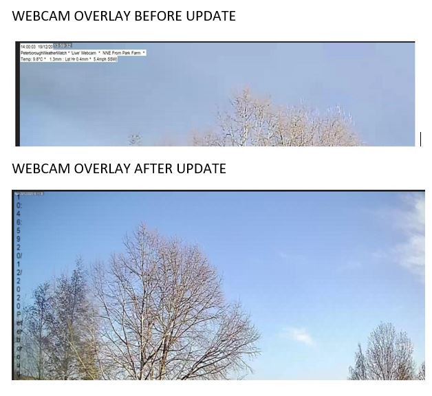

I just upgraded to build 121. It seems the tags in the text over lay are not being interpreted. tags are just showing as text
I had an issue with the webcam text overlay as well after updating to the latest build, however this was rectified by restarting the webcamcaptue component.

Yeah, it rectified it for a bit, but the issue is there again. Attached prints show the issue a before and an after.
Also gone back to build 120, and overlay is OK

there is a new version of the wdwebcamcapture
it works OK for me with the custom tags
so not sure its not for others

try this update
https://www.weather-display.com/downloadfiles/wdwebcamcapture.zip
and then change the width setting from 10 (too small) to say 100
and click on set then save
in the overlay tab
