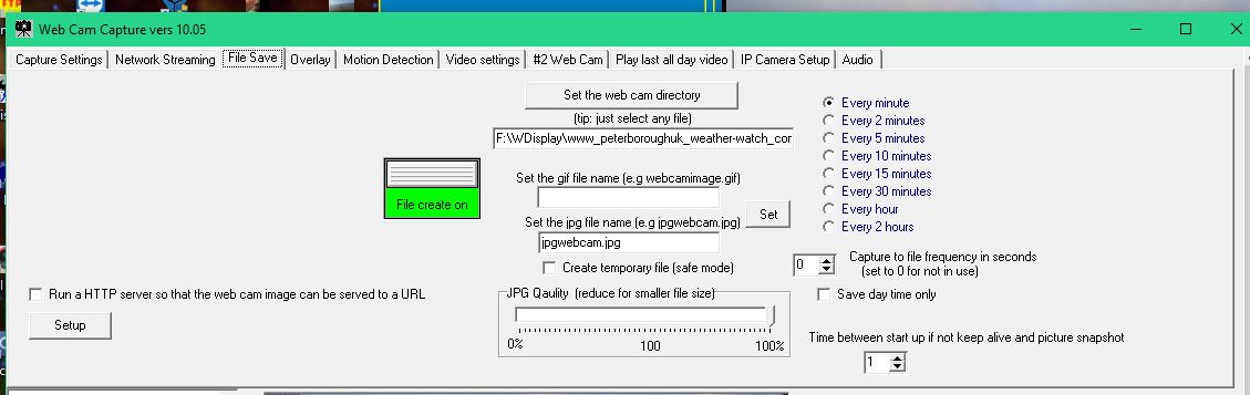

What are your settings under the file save tab?

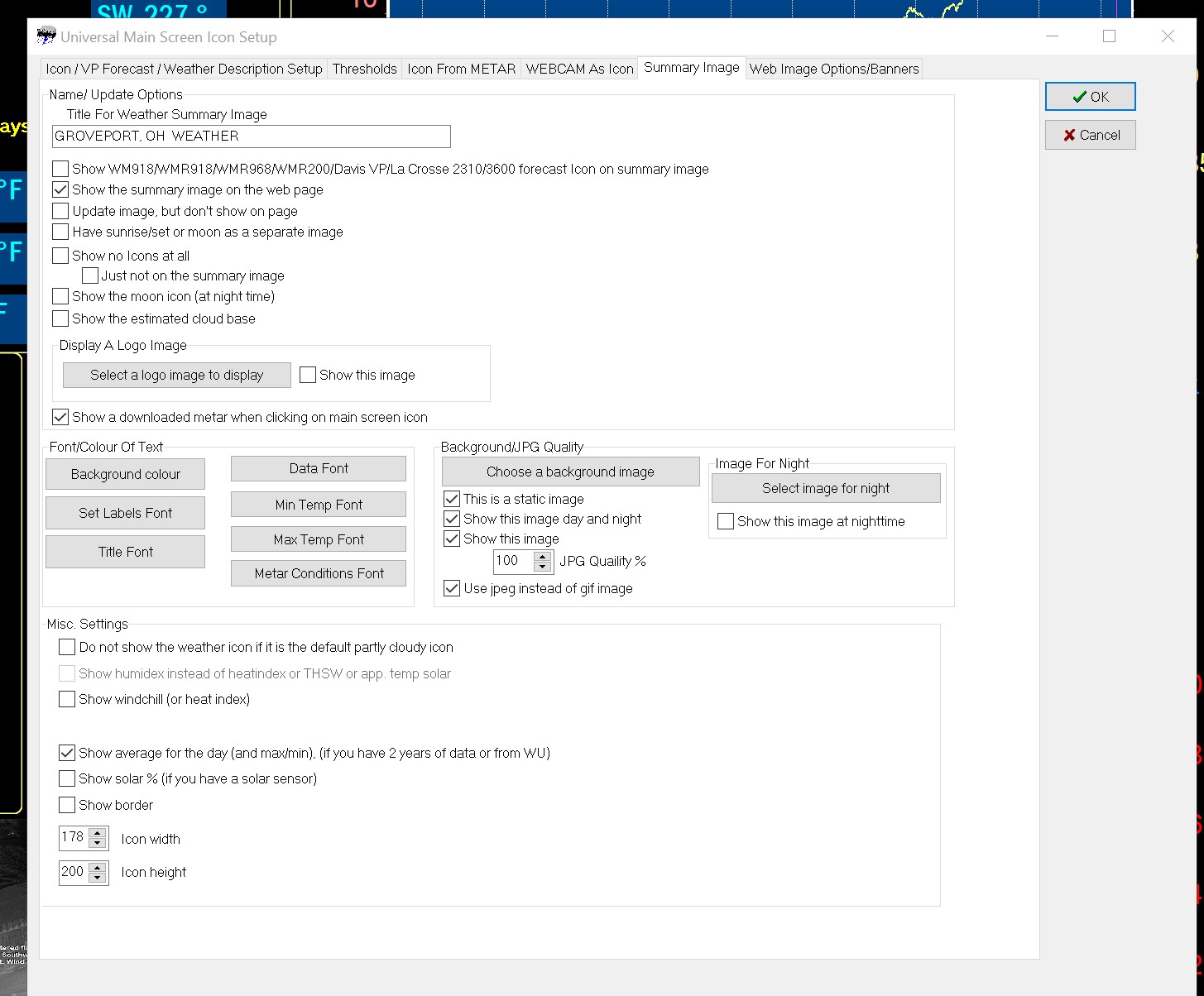

Also…old problem for me…minor …but when I turn off icons for summary image, it does not work…icon image stays put…no big deal…but Ill take your thoughts if any…

see attached screen grab
TrevP
Looks the same as mine except I save a gif as well. I have reverted back to 10.05 wcc.exe until Brian resolves issue. Before I upgraded to wd 122 now 123 I saved the old wcc 10.05 by itself. Glad I did…and just replaced the new wcc with the old one…see link

Also..old problem for me...minor ......but when I turn off icons for summary image, it does not work...icon image stays put...no big deal...but Ill take your thoughts if any..
i tested here...it works
but it might be something different you are doing…screen shots?

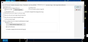

Here ya go Brian
its the setting to show web cam image instead, show on main
WD assumes that its also wanting to be shown on the summary image
I could either make sure that is honoured by the show no icons on summary image or add new setting…not on summary image…in the web cam as icon setup
That would be nice,I still want webcam on main screen as icon (24 hrs)…but its too busy for my summary image…Thanks and sorry this thread kinda got sidetracked…Ive reverted back to wcc version 10.05 for now btw

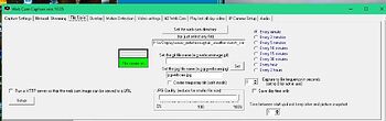

vers 10.36
This is what I see.
10.05 shows perfectly
One thing I just noticed was in 10.36 the setup # is 2. In 10.05 the setup # is 1
