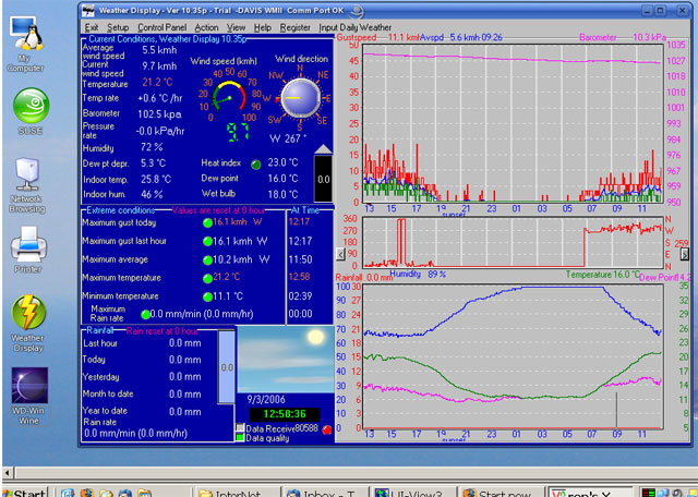

Well I REALLY REALLY wanted to run WD on Linux but I don’t want to replace my Suse server to do it.
While the new version of WD-Linux (5.5g) works much better, it will not run 24/7 nor even 24 hours on my Suse10.1 server. At best I can run it for 14 hours or so before memory use goes over 75%.
So after wrangling Wd-Linux for the past two weeks, I remembered a post about running WD(windows) on Linux using WINE. I figured this was my last shot. Well as it turns out, installing WINE and then Wdisplay32.exe was slick and easy. (There are others posts and info on doing this so I won’t repeat it)
While I hope Brian continues to develop and support Wd-Linux, the Windows version under Wine does it all for me. After more than 2 days running its very stable, uses less than 8% memory and no leaking.
Here are some notes, comments on this arrangement:
  1. As I did with WD-Linux, I was able to redirect DISPLAY so that the program could be started in a remote-VNC desktop session and left running when I disconnected.
  2. I start the program from a desktop icon pointing to 'wine “Y:\windows\WeatherD.exe” ', with work path of “/home/username/windows”. (Application was installed in this folder)
  3. While I had problems changing locations for webfiles/clientraw.txt with WD-Linux, this was slick and easy using WD-win/Wine. My webfiles were easily stored (without ftp) in ‘/srv/www/htdocs/wx’ for my web-server and the clientraw.txt for WDL sent to ‘/srv/www/htdocs/wdl’. WD-win/Wine can access all areas of the Linux box not just ‘windows’.
  4. APRS ftp to my jAPRS server was also easy and reliable under this setup.
    Even WXNOW.TXT was created properly for use with UI-View although I don’t need that now with the APRS/CWOP running 24/7.
  • So almost everything I tried to do with WD-win/Wine worked as expected and continues to run reliably.
    The only thing not worked out yet is the wdmysql program. Since this is separate I’ll have to spend some time on its configuration but its not part of my main project.
Attached is a screenshot of my WD-win/wine running remotely from a vnc-desktop connection.
Cheers,
Ron
