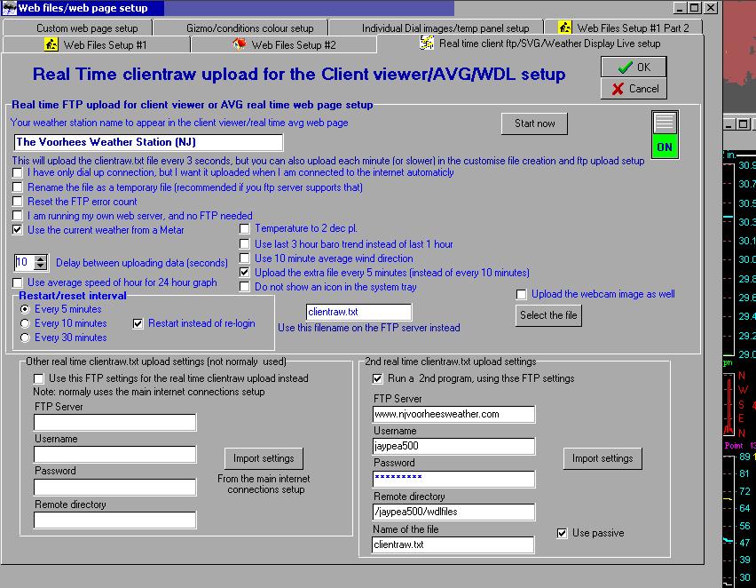

For number 2, you can set the frequency via the realtimeftp for updating the clientraw for WDL. Maybe post a screen grab of your realtime setup page.

  2. screen grab attached below.

also i see you have in use the 2nd clientrawreal time ftp…did you mean to be using that?

yes. I’m assuming (perhaps wrongly?) that I need that to get clientraw.txt into the wdlfiles folder for WDL as the main ftp is just putting it into the home directory.
