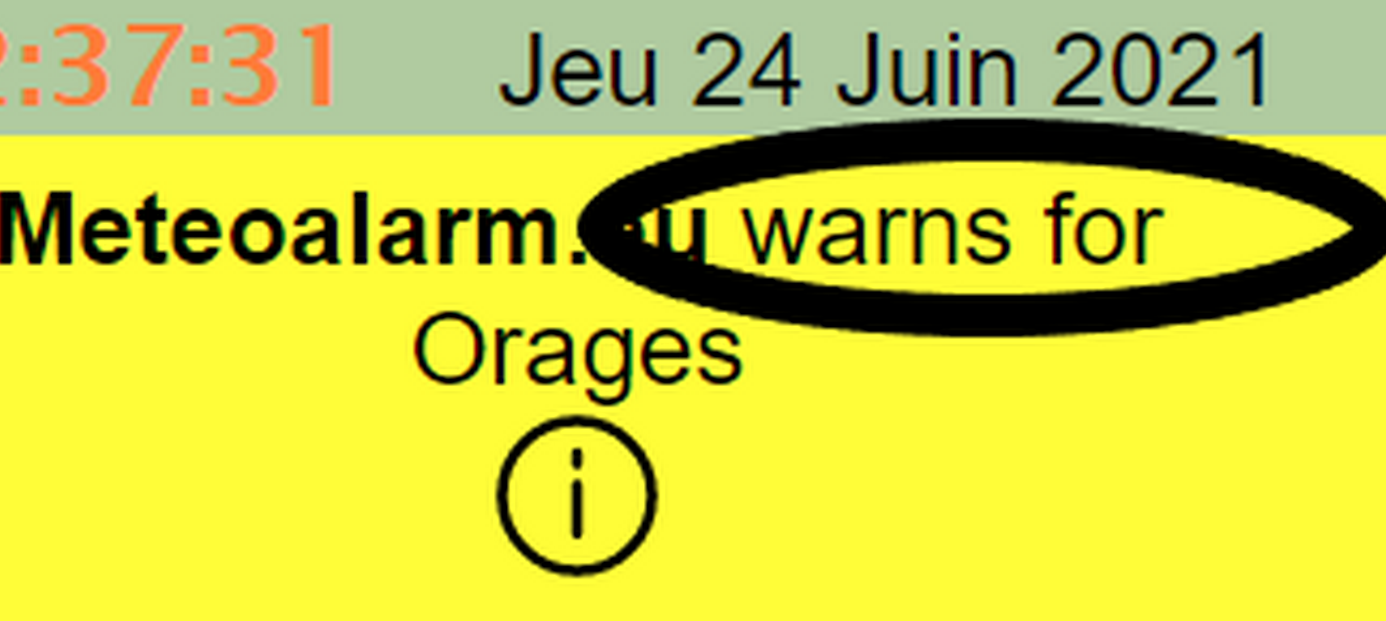

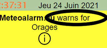

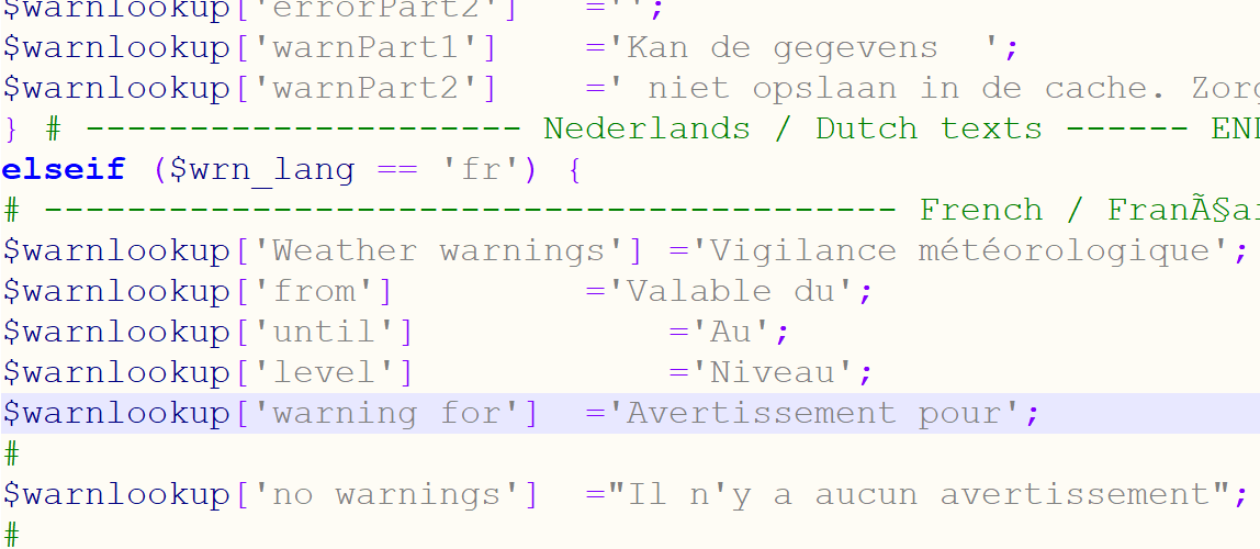

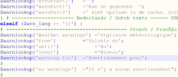

Hello WIM,
When warning there are warns for
By putting Warns for the French translation works ( File: wrnWarningEU.php )
THANK YOU

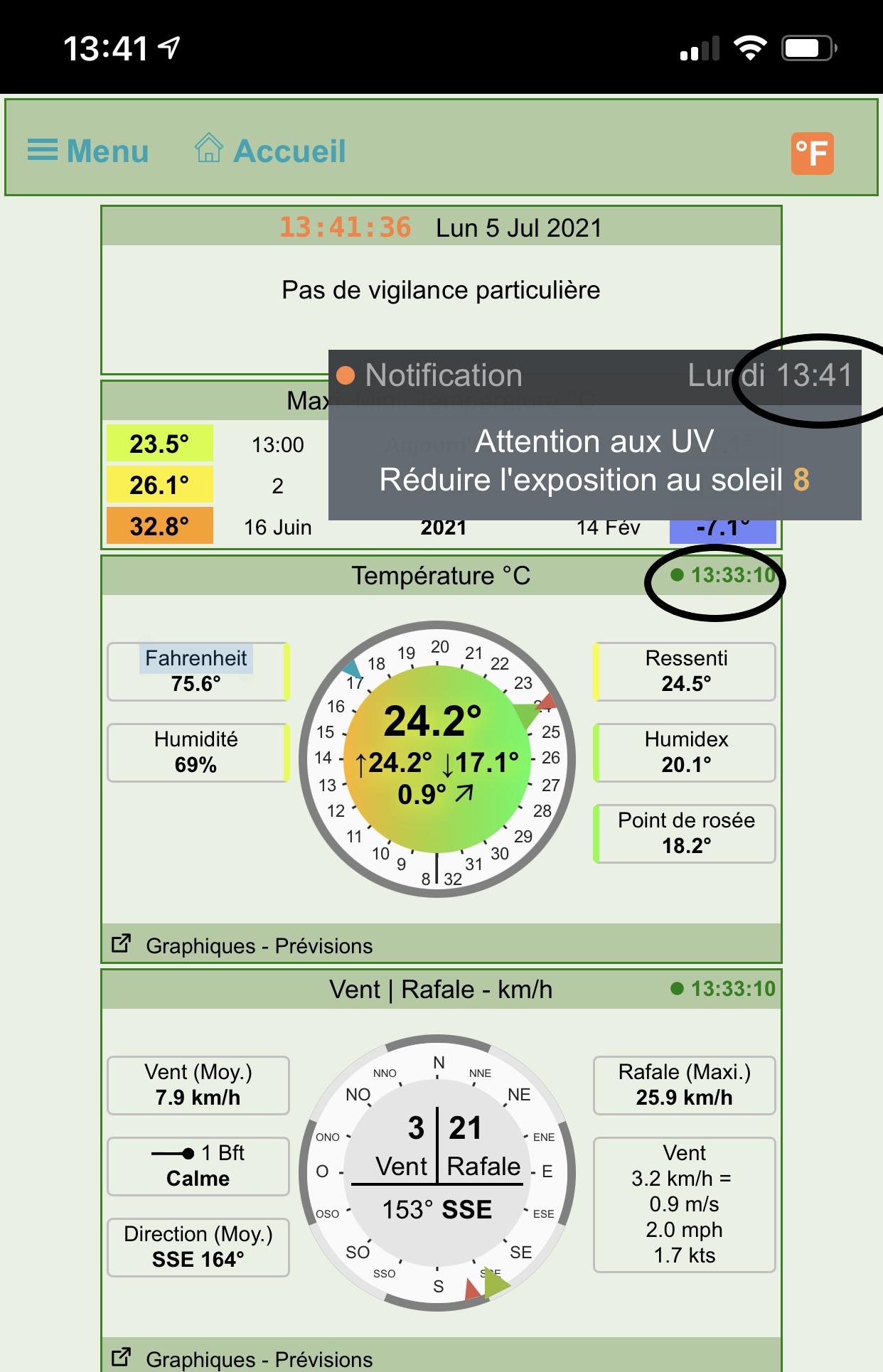

Hello WIM,
Since the last update I noticed that the data is no longer updated every 2 minutes as programmed on the METEOBRIDGE yet the file does appear every 2 minutes in the DIR / demodata
Is it a problem with my host ( PHP version ) or a problem with incorrectly replaced files following the June 18 update?
http://www.fleurie-meteolive.fr/
Thank you in advance for your help
Cordially

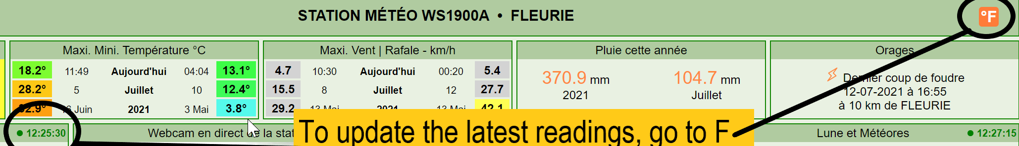

Hello WIM,
I am once again having trouble displaying the latest readings, however the demodata / realtimeMB.txt file is present
I found only one solution to display the last readings you have to switch to F (photo attached)
Is it due to my host?
I tried with Google Edge Safari … ditto
http://fleurie-meteolive.fr/
Thank you in advance for your help because I can’t find why it doesn’t update automatically
Cordially

Hello,
The problem was due to my host for two days no more worries
Thank you for your help
