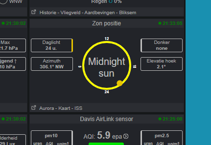

I just don’t understand the sun block.
What does “Midnight sun” mean, see screenshot?
greetings Arie
https://www.meteo24-culemborg.nl/pwsWD/index.php
Sorry for that error, one of the last “clean the code” changes was not tested in normal situations.
Midnight sun means no night-time, as on the north-pole at this moment.
Attached the corrected script, will be testing this tomorrow, my time.
sun_c_block.php.zip (5.62 KB)

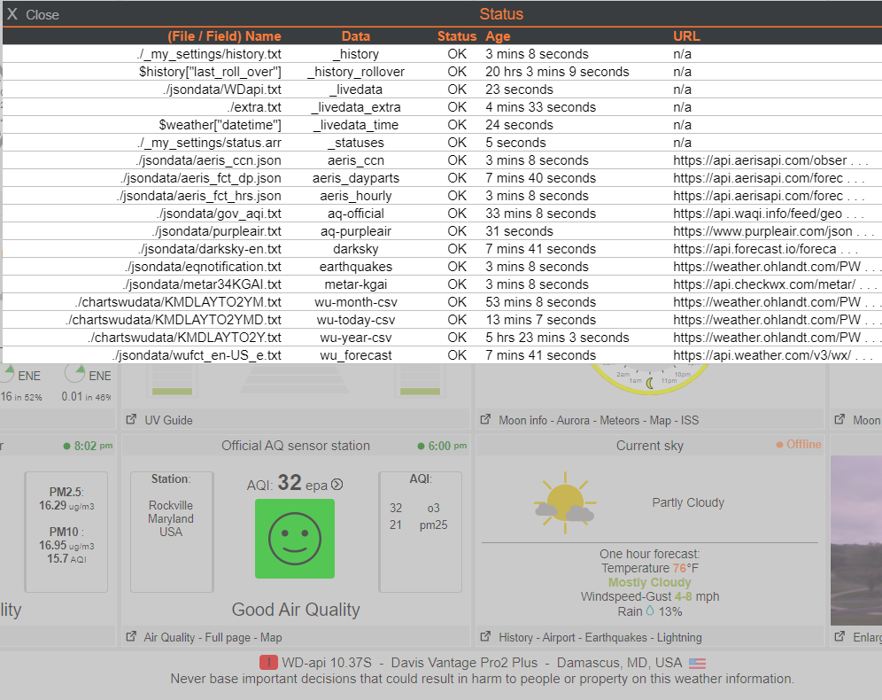

Wim,
I installed the updates this morning and now seem to have a permanent red exclamation mark for status despite all reporting as ok (see attached).
-Chris

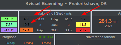

I believe the following problem has occurred in connection with the latest update:
There is no color indication for some values in Max wind / gust.
Mogens

Attached update script .
wind_c_small.php.zip (3.21 KB)

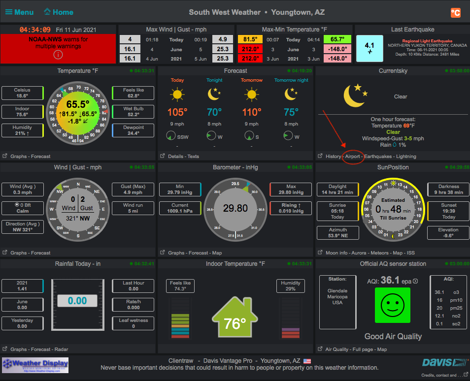

Hi, When I click on the airport link I get a screen that says Invalid Data Array. I notice this after updating.
Link to site https://southwestweather.com/pwsWD/index.php
BTrip
You selected to use Aeris forecast and current-conditions data.
The popup uses . . ./pwsWD/jsondata/aeris_ccn.json which only contains an error-message.
{"success":false,"error":{"code":"insufficient_scope","description":"The client provided is not authorized to access the request."},"response":[]}
All three files have similar messages.
Please check your settings. Probably you had a type in the Aeris password/key settings.
If you can not locate the problem, you can mail me your settings-password so I can check what went wrong.
Hi Wim that fix the problem.
Thank again
BTrip
