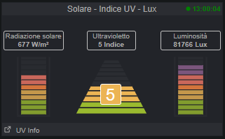

Hi Wim,
Yesterday I updated this script with all updates for some time.
Since then I have seen a problem with the sun block.
See attached picture.
What do you think the problem is?
The url to the page is: Assen Home Weather Station (WDapi version)
Many thanks,
Oebel
See http://discourse.weather-watch.com/p/553629
Maybe you updated before Wim uploaded the corrected script?
I downloaded and installed the download yesterday, June 10.
I think the wrong sunblok file was still in there.
I have now found the correct file by reading all the messages.
thanks.
Resolved.
Brgds,
Oebel
I think you downloaded the large update 2021-05-23 with all updates as from 2021-05-23 - till yesterday.
Shortly before I uploaded the extra small update with the 5 scripts from the update discussion with the 2021-06-10 updates.
When I check your scripts there are still the 4 other updated scripts you need to install from 2021-06-10: fct_aeris (2 scripts) , fct_wu and wind_small.
Better re-run . . ./pwsWD09/PWS_updates.php

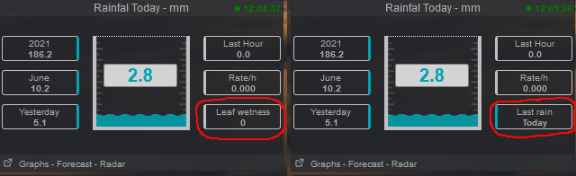

Made the latest update.

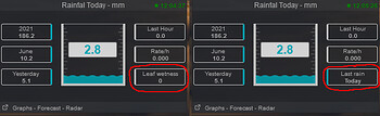

Updated pws_livedata, and last rain changed to leaf wetness in the rain_block
I comment line 1516 in pws_livedata to work around this.
$weather [‘leaf_wetness1’] = (float) $wd [156];
I do not use extra sensors
:oops: Thanks, forgot to make the values optional.
Attached updated version, will test 1 day and then upload.

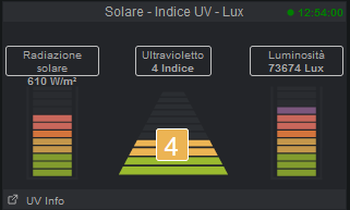

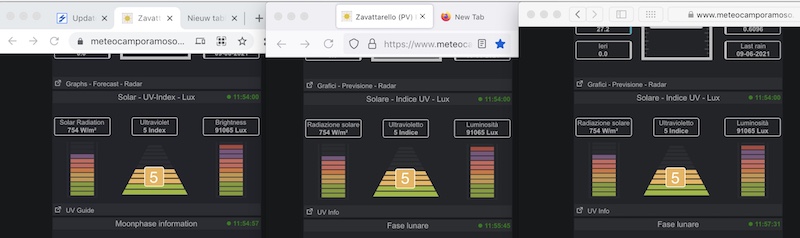

After the last update in the solar radiation box, the value exits the box
https://www.meteocamporamoso.it/pwsWD/index.php
Can not confirm this (yet).
Using Chrome, FF and Safari all texts fit.
There is no more room available in that block to make the texts larger.
What browser and what device are you having this problem with?
I can confirm his problem with Firefox 88/89 on a Win 10 machine. Typeface is the same but the text appears letterspaced. Chrome/Edge are OK.
MatteoPV seems to be using Firefox in Win 8.1 (NT 6.3)?
Yes, I installed latest release of FF on windows 10 also.
It has this problem, it needs 1 pixel extra to display the two words on one line.
Chrome and Edge work fine on Win-10 also.
@MatteoPV The only solution I can think of, is using a different translation. Use only “Radiazione”
IMHO, “Radiazione” in this “Solare - Indice UV - Lux” block is as meaningful as “Radiazione solare”
