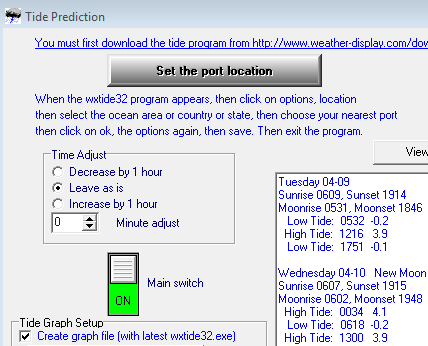

Not sure if this is the problem, but I fixed my tide time by ticking “local” in the attached screenshot.

Not sure if this will help, but since were in the same area, attached a SS of my settings.
That’s exactly how mine is set Mark!! The problem is my tides match the NOAA website BUT the locals here tell me the actual low tides in this area are 1 hour before what the NOAA tides show…and in the tide book you get here locally it even states you need to take 1 hour off the times listed for this location…??? #-o :frowning:
In WD - Control Panel - Solar/Lunar & Coordinates-> Show Tide Times, have you tried offsetting the time? See screenshot.
harwx i have mine set to decrease 1 hour but it did not change anything when I did it the times all stayed the same…?
