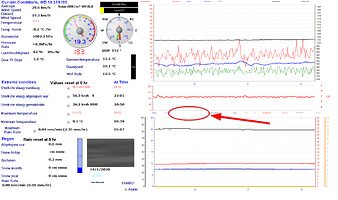

This is what it looks like right now when I try to align the labels. (Please see attached pic.)
It’s there. But not when the graph output is generated every five minutes’. Actually… Now ‘UV’ is gone as well… http://meteohilversum.nl/index.php?p=64&lang=nl#data-area

For the record… The fact that the word ‘Solar’ is visible in the screenshot I posted, does not mean it worked. The screenshot was taken from within WD, during an attempt to set things up.
As can be seen here here, the word ‘Solar’ still won’t show :frowning:

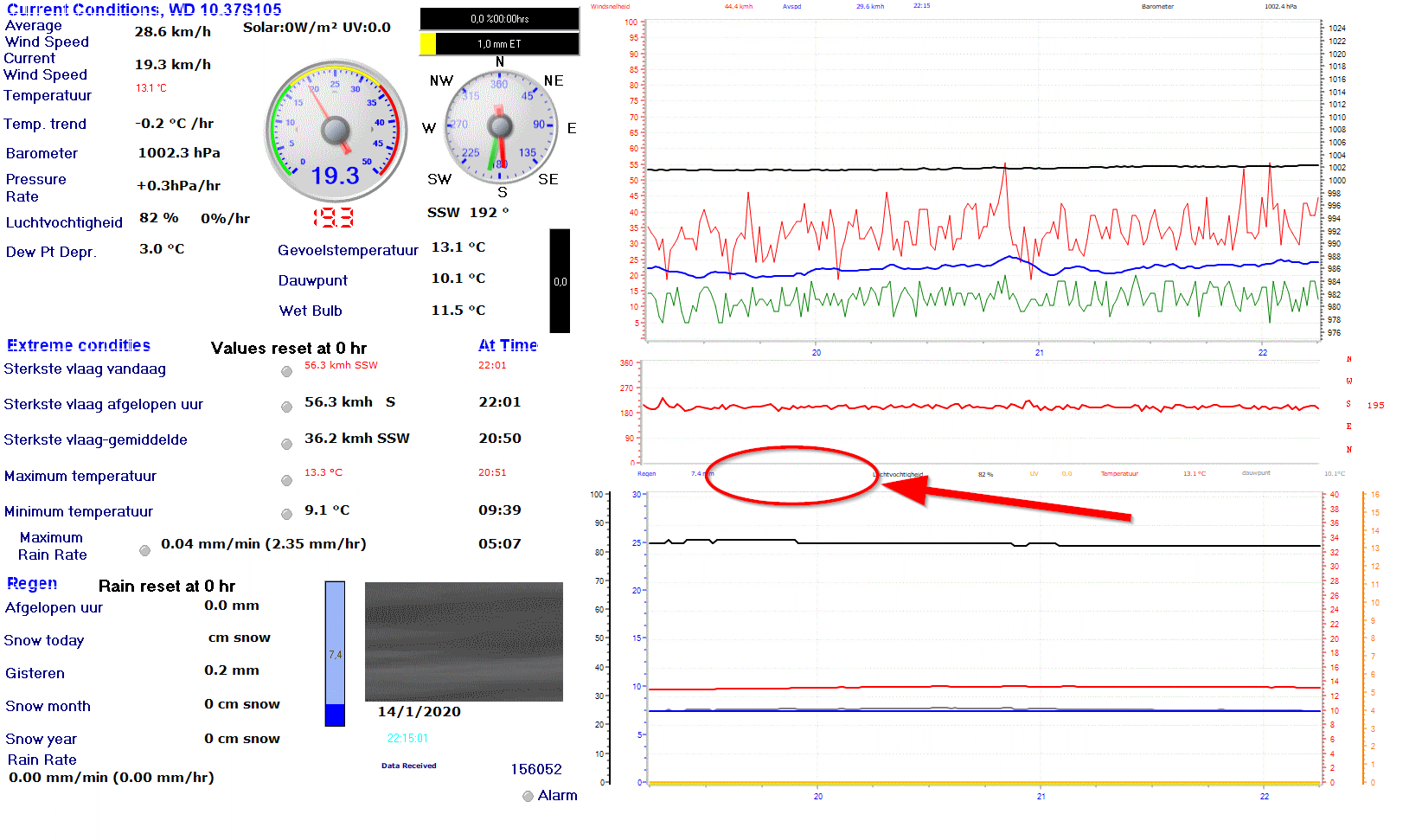

The screenshot of WD that is automatically made every five minutes also doesn’t display ‘Solar’!
(see attachment Hilversum.png)
So it’s not somehow just not included in the “regular” graph, but it’s also somehow not being included in the main window screenshot.
I mean, in WD it is there alright (see attachment solar.png), but when the automatic screenshot is made, it’s not on there 8O
Does this maybe help in determining the cause of the problem?

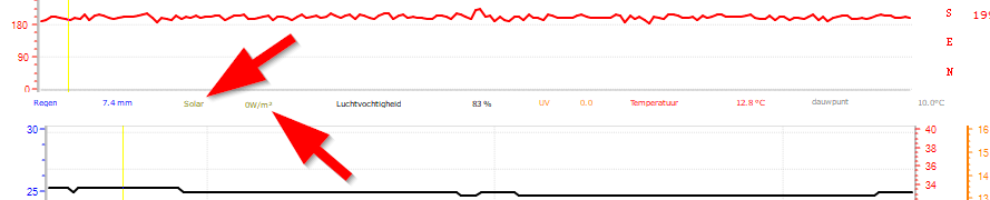

try a new .zip update
(the issue was you had set to not show indoor temp/hum)
Yes! It worked! The word ‘Solar’ is there! Thanks.
That is, it is now hiding behing another label. I thought I knew how to change this, but when I did, only the 72hr graph changed, and after restarting WD, it turns out this change wasn’t saved, because now ‘Solar’ is hiding again. But at least it is there :slight_smile:
