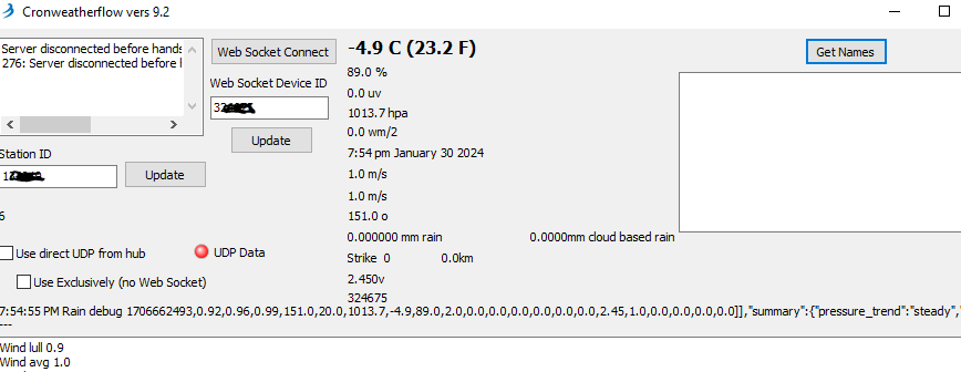

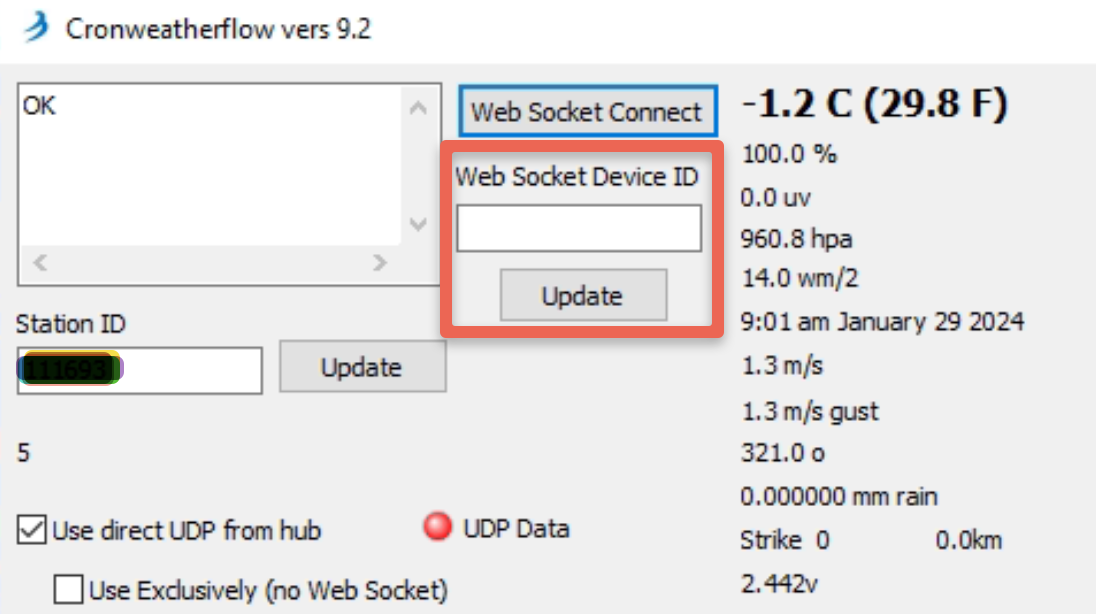

Appears he made more changes…I have no idea what goes in the “Web Socket Device ID” block.
Cronweather 9.2:
Your device number goes into the block you are showing .Go to your android Tempest Weather app open it . Then in the upper right corner is the tempest station icon . Tick on it . Then on the lower right is settings . Tick on it . On top you will see Manage / stations .Tick on it . It will open showing your weather station name you put in .tick on it . it will open to a drop down menu beginning with your station name. scroll down until you see Status. Tick on Status . On this list you will see your station ID and your Device ID . Put your Station ID in first block and then your Devive ID in the other block. Then close Weather Display and then restart it . Your rain data should now be reporting. Cheers

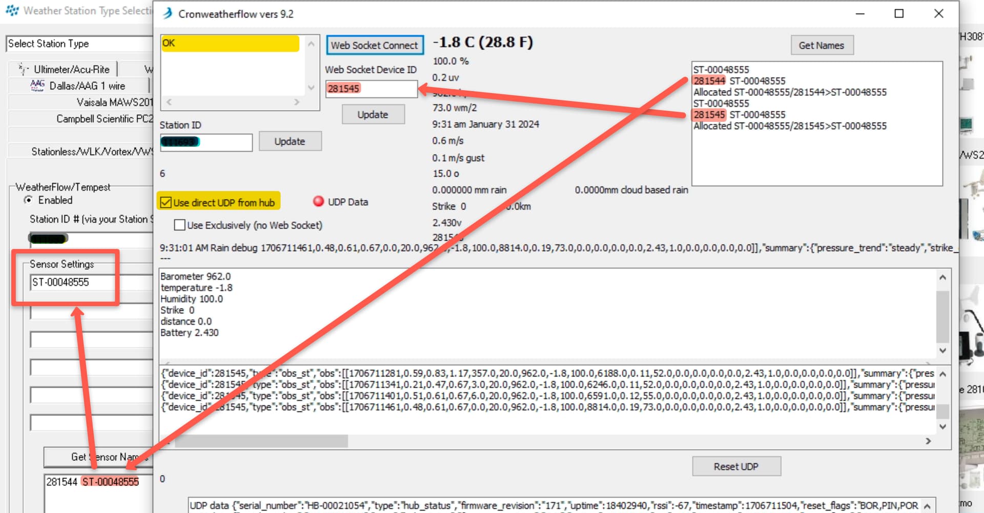

Recommend using the “Get Names” to find your device ID’s since your Tempest will have 2 device ID numbers and you don’t want to be using the HUB device ID.

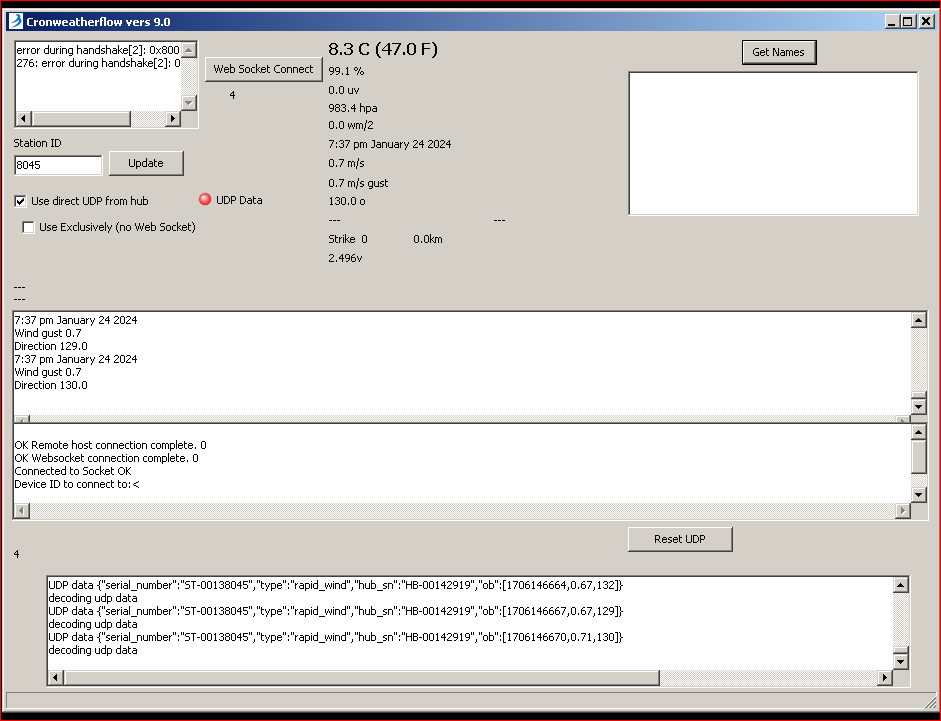

Why do I keep getting errors, in order for rain to work I cannot use UDP, is this correct?
I keep receiving these errors, I even tried reversing the numbers.
and if I click on get names, it displays nothing, and then Cronweatherflow crashes. crashes.
If I use the update buttons Cronweatherflow crashes
errors below
Server disconnected before handshake completion [0xffffffff].
276: Server disconnected before handshake completion [0xffffffff].

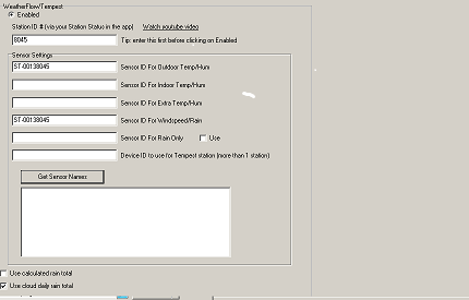

I did a brand new install of WD setup station clicked get names it is empty
Cronweatherflow gets the data but does list names when I click on get names, also get a server disconnected error.

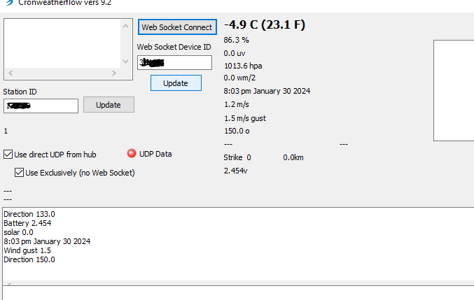

Get sensor names doesn’t work for me but the UPD is receiving data of all sensors . I find that cronweatherflow not getting sensor names has no effect as to ability of getting/sending sending data to Wdisplay dashboard .
Everything on the bottom image is set correctly and is the same settings (IDs and ticked all works) and as you and said all sensors are being reported and sent . But as for the Cronweatherflow 9.2 , becoming unconnected, I have no Idea as to how to correct that . Maybe someone on this forum has experienced this and found a fix . Sorry, I wish I could help you . I would definitely send an email to Brian .:sunglasses: Brian is very good at fixing / correcting issues with Wdisplay and cronweatherflow . He worked with me for several hours emailing me for info then sending info for me to input until the problem was solved . Look forward to hearing from you that disconnect issue is fixed . Cheers

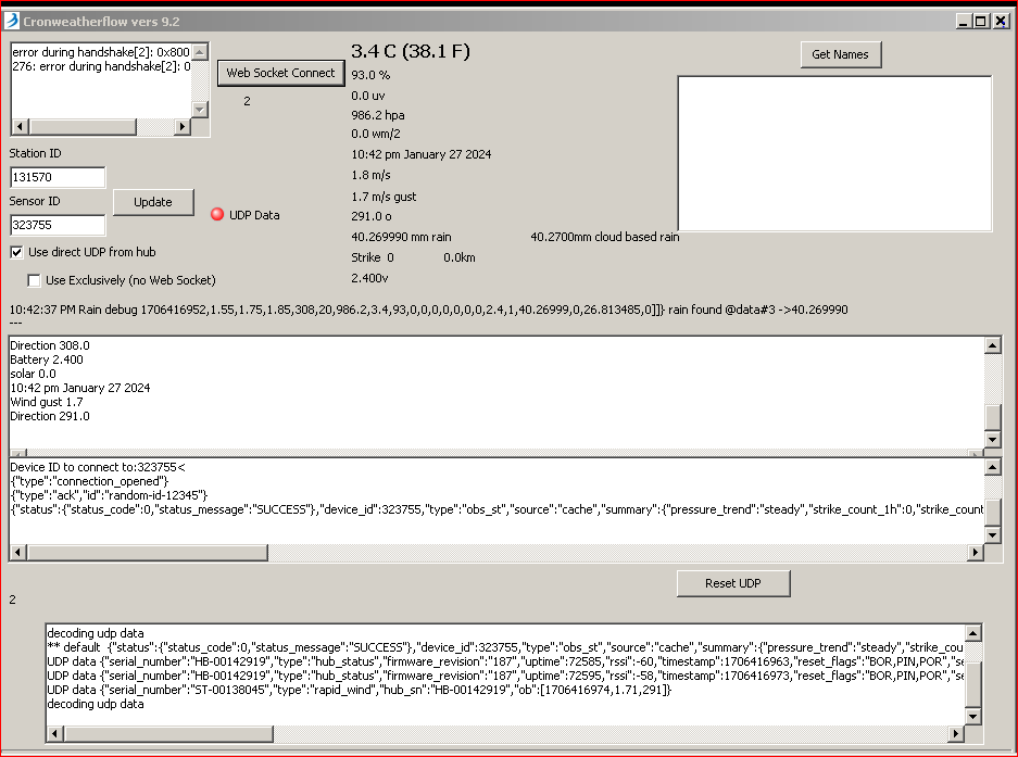

My current setup with cronweatherflow9.2. Not having any issues here…but still waiting on rain to verify. Hopefully you find this useful.
