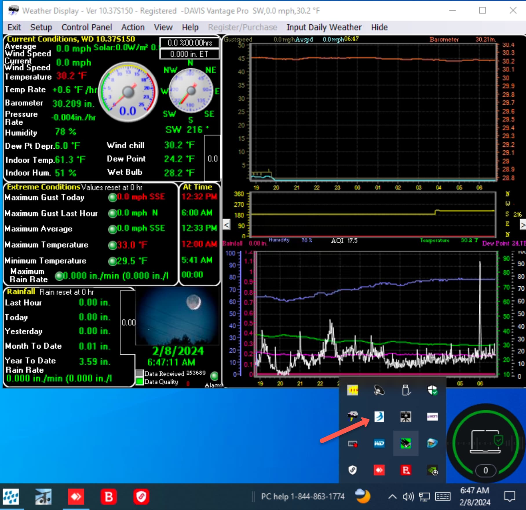

How do you access and view the cronweatherflow setup shown.
When you choose weatherflow as your station type , cronweather should open with croweather icon in Taskbar. Double click on the cronweather icon and it will open so as to put in station and device ID’s…
Taskbar, right-click the icon
Thank you, have found the icon.
