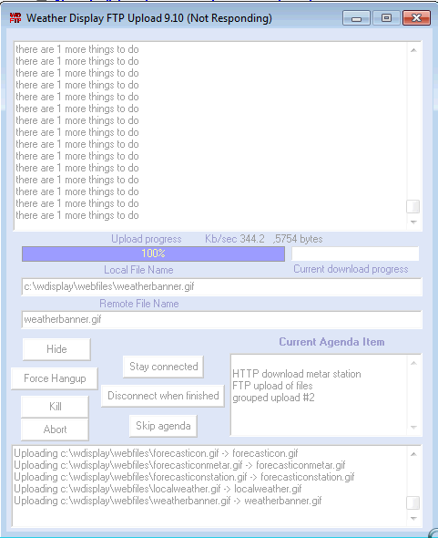

Brian - I was doing some testing on this as I am trying to get testtags.php to upload using the new check box, however I found that when I went to Web Files Upload and selected “Upload Now” everything would upload fine (minus testtags) however ftpupd.exe would stay in the system tray (hovering over it showed 100% weatherbanner.gif - the last file to be uploaded). The log said all done and closing the program however it never closed. Click upload now again and same thing but two ftpupd’s running, do it again and 3 running.
It seems like the shutdown process isnt completing as you cannot bring up the ftpupd window, its just a runaway process until killed.

Right, didnt get the log as it is not written on the Upload Now but open the ftpupd window while it was uploading and got it caught there. After it uploads the last file weatherbanner.gif it scrolls with “there are 1 more things to do” many times and then stops responding. Thats where it gets stuck. I have a screenshot for you when I can work out how to upload images to the forum
Oh and while this ftpupd instance is hung the scheduled one works fine too

b1, looks like a program LOOP
I see it says, doing grouped upload #2
in the agenda schedule
what do you have set there?
