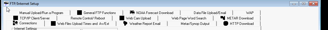

Where would I check for this as I am pretty sure I dont have any grouped upload. Looking in View>FTP Log there is no grouped stuff for the scheduled upload and also in the list of files to be uploaded
grouped upload is in the ftp/internet setup , grouped upload setup
check there
I cannot find that anywhere, must be blind but I have had a good look
its there
control panel, FTP/Internet setup
Grouped upload

im sorry, I just dont see it. Here is the tabs I see under ftp/internet
its under General ftp, the grouped uploads
Nothing set there, see attached picture.
Please note that on the scheduled upload of files the only thing listed is Upload of files, nothing else
Oh and this is not an issue for me as the schedule works perfectly and I dont use the upload now - just thought the issues were the same so may help for Larry
no, not the same issue
not sure why you are getting the error you are getting via the upload now
I would need your settings files to see if I can duplicate that error here
