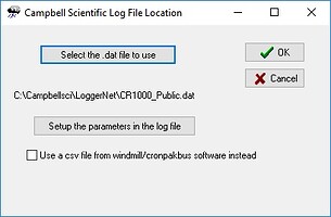

Yes, im using the data position input and cronpakbusnew is constantly running.
Or is it more easy for you to have WD running with loggernet so loggernet updates the. Dat file which WD use for the (realtime) data?

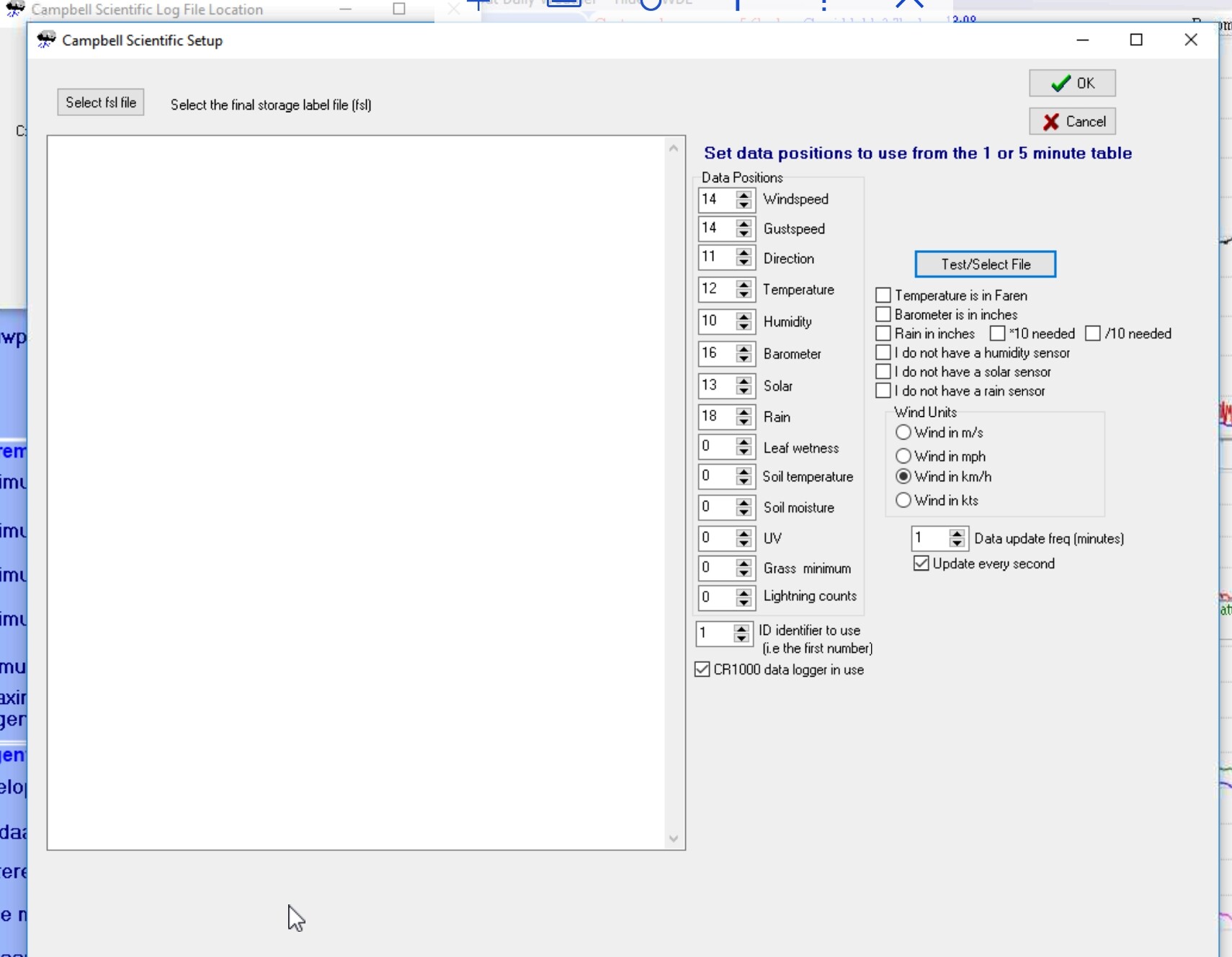

post a screen shot of how you have it setup in WD
Here are the screenshots. :smiley:

What data position should i use for the precipitation type?
And where can i see it on the mainscreen?
The dataposition, is it the position in the data string?
are you using the file setup?
it looked like you are in the settings
and so that new data will be a data position in the file
you should then see the raw data under view, debug info
but it depends on how you have WD set up
it looks like you have it setup more than one way

ive made some screenshots.
as you can see i cant find the precipitation type in the debug code and in de campbell setup, the first and second picture.
And the datafield numbers im not sure if these are correct, third picture.

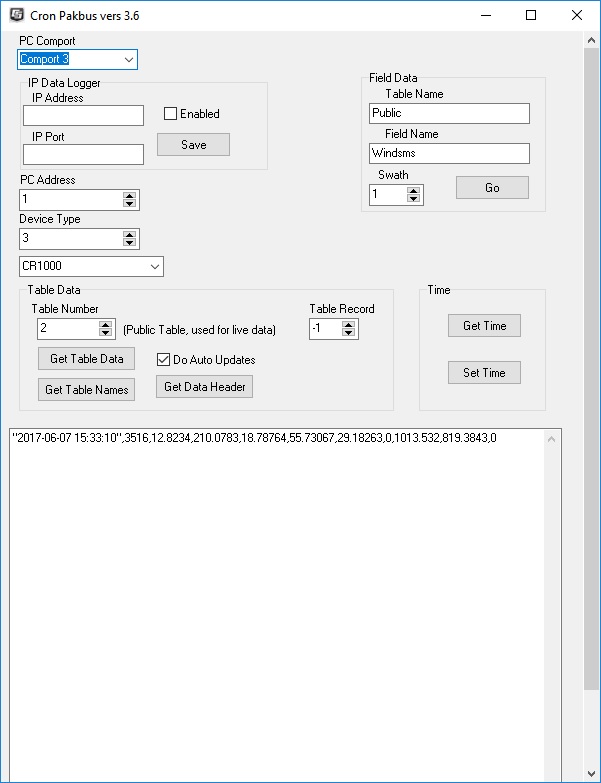

I will have to add the data to the cronpakbusnew program
as it looks like you are using that method
what shows in that running program ?
Is there a more easy method for you?
Below is my cronpakbusnew screen…
