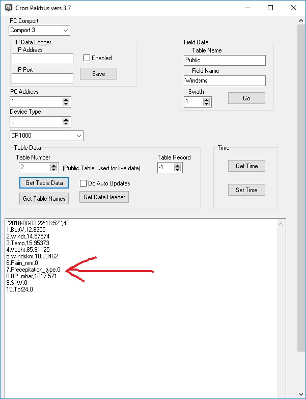

hi Brian,
i stopped cronpakbusnew updating and looked at the data, it looks like the precipitation is present, see pic below…
that is good
Ok great.

what happens when you click on get data header
and then what shows in
pakbustabledatanames.txt
This is showing in pakbustabledatanames.txt:
Pakbus connection result 0 to comport #3
Get header data 0
“TOA5”,“station”,“CR1000”,“20810”,“CR1000.Std.32.02”,“CPU:Weatherdisplay1 basis -met R2S.CR1”,“49407”,“Public”
“TIMESTAMP”,“RECORD”,“BattV”,“Windr”,“Temp”,“Vocht”,“Windskm”,“Rain_mm”,“Precepitation_type”,“BP_mbar”,“SlrW”,“Tot24”
“TS”,“RN”,“Volts”,“Deg”,“DegC”,“%”,“kph”,“mm”,“”,“mbar”,“W/m^2”,“”
good oh, it shows there

it looks like its there then, just after the rain value
this is good
I can work on adding support
will work on that today
