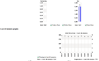

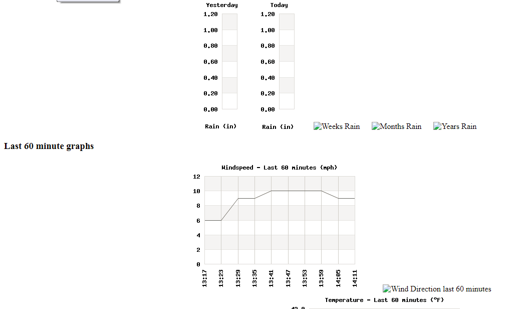

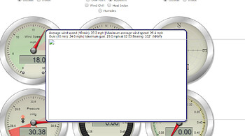

After a lot of time, I have finally got the SteelSeries graphs working. My question -

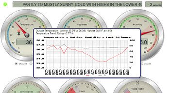

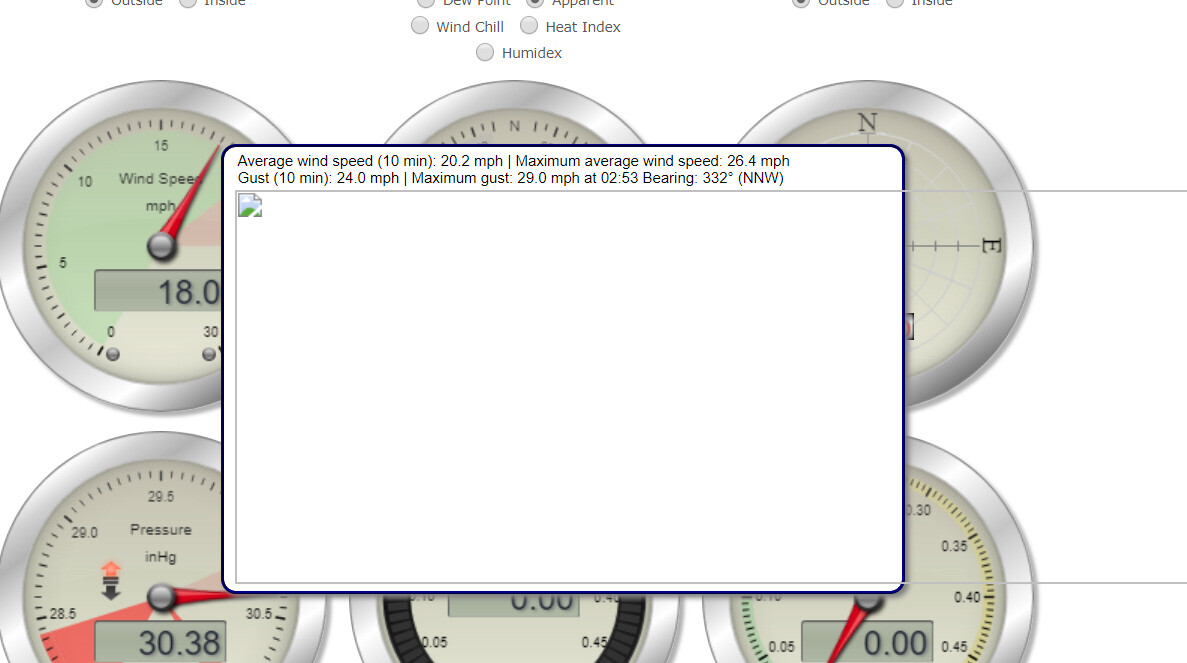

When I hover over a gauge, the graph appears - sometimes on some of the graphs, but not always. See the 2 attached files created 1 minute apart…
Graph Test resolves all graphs:
Also, if the graph does not appear, if there is a selection (like MPH or KPH) and I click it, it sometimes triggers the graph.
Anyone have any thoughts on this?

I see basically the same problem with the wxgraphs_test.html test page so it doesn’t look like a steel problem. Maybe try re-installing jpgraph? I’m not sure what else to suggest :frowning:
I notice the test page with multiple graphs loads very slowly, but graphs that are often problematic on the test page work consistently when accessed directly e.g. http://www.cdcpcconsulting.com/wxgraphs/windspeed_60min.php
Is your server short of resources maybe?

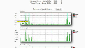

The problem does seem to be when there are multiple graphs being requested. If you have cpanel it should have some useful info.
I set up a test page on my server hotlinking your graphs and I can only reliably show two graphs on the page, and more than two and it’s a crap shoot whether they will all show.
Thanks Nike - I have cpanel, but do not know what I am looking for. I have opened a ticket with Hostmetro (ISP) and we shall see what they say. If you would like to see cpanel for yourself, PM me and I will give you access.
What I did find is in the attachment.
Thanks again
Craig
As I recall in cpanel you should have a lot of stats on the left side like this screenshot I grabbed off the web, and there are also some graphs under Logs, Resource Usage.
I will post a screen shot. In the meantime after 2 back and forths, this is the latest response from them. Does this make sense??

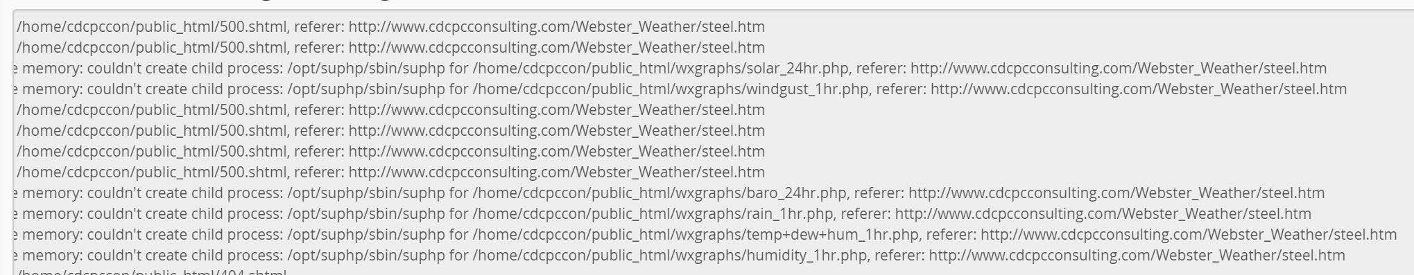

I opened the test page and then the gauges page, and went to the error log on the server, and this is what I got…
[Sun Apr 22 10:34:54 2018] [error] [client 74.67.155.152] File does not exist: /home/cdcpccon/public_html/500.shtml, referer: SteelSeries Gauges
[Sun Apr 22 10:34:54 2018] [error] [client 74.67.155.152] (12)Cannot allocate memory: couldn’t create child process: /opt/suphp/sbin/suphp for /home/cdcpccon/public_html/wxgraphs/solar_24hr.php, referer: SteelSeries Gauges
[Sun Apr 22 10:34:54 2018] [error] [client 74.67.155.152] (12)Cannot allocate memory: couldn’t create child process: /opt/suphp/sbin/suphp for /home/cdcpccon/public_html/wxgraphs/windgust_1hr.php, referer: SteelSeries Gauges
[Sun Apr 22 10:34:54 2018] [error] [client 74.67.155.152] (12)Cannot allocate memory: couldn’t create child process: /opt/suphp/sbin/suphp for /home/cdcpccon/public_html/wxgraphs/temp+hum_24hr.php, referer: SteelSeries Gauges
[Sun Apr 22 10:34:53 2018] [error] [client 74.67.155.152] (12)Cannot allocate memory: couldn’t create child process: /opt/suphp/sbin/suphp for /home/cdcpccon/public_html/wxgraphs/humidity_1hr.php, referer: SteelSeries Gauges
[Sun Apr 22 10:34:53 2018] [error] [client 74.67.155.152] (12)Cannot allocate memory: couldn’t create child process: /opt/suphp/sbin/suphp for /home/cdcpccon/public_html/wxgraphs/baro_24hr.php, referer: SteelSeries Gauges
[Sun Apr 22 10:34:53 2018] [error] [client 74.67.155.152] (12)Cannot allocate memory: couldn’t create child process: /opt/suphp/sbin/suphp for /home/cdcpccon/public_html/wxgraphs/temp+dew+hum_1hr.php, referer: SteelSeries Gauges
[Sun Apr 22 10:34:51 2018] [error] [client 74.67.155.152] File does not exist: /home/cdcpccon/public_html/500.shtml, referer: http://www.cdcpcconsulting.com/wxgraphs/wxgraphs_test.html
[Sun Apr 22 10:34:51 2018] [error] [client 74.67.155.152] (12)Cannot allocate memory: couldn’t create child process: /opt/suphp/sbin/suphp for /home/cdcpccon/public_html/wxgraphs/rain_this_year.php, referer: http://www.cdcpcconsulting.com/wxgraphs/wxgraphs_test.html
[Sun Apr 22 10:34:50 2018] [error] [client 74.67.155.152] File does not exist: /home/cdcpccon/public_html/500.shtml, referer: http://www.cdcpcconsulting.com/wxgraphs/wxgraphs_test.html
[Sun Apr 22 10:34:50 2018] [error] [client 74.67.155.152] (12)Cannot allocate memory: couldn’t create child process: /opt/suphp/sbin/suphp for /home/cdcpccon/public_html/wxgraphs/rain_week.php, referer: http://www.cdcpcconsulting.com/wxgraphs/wxgraphs_test.html
[Sun Apr 22 10:34:39 2018] [error] [client 74.67.155.152] File does not exist: /home/cdcpccon/public_html/500.shtml, referer: http://www.cdcpcconsulting.com/wxgraphs/wxgraphs_test.html
[Sun Apr 22 10:34:39 2018] [error] [client 74.67.155.152] (12)Cannot allocate memory: couldn’t create child process: /opt/suphp/sbin/suphp for /home/cdcpccon/public_html/wxgraphs/baro_7days.php, referer: http://www.cdcpcconsulting.com/wxgraphs/wxgraphs_test.html
[Sun Apr 22 10:34:37 2018] [error] [client 74.67.155.152] File does not exist: /home/cdcpccon/public_html/500.shtml, referer: http://www.cdcpcconsulting.com/wxgraphs/wxgraphs_test.html
[Sun Apr 22 10:34:37 2018] [error] [client 74.67.155.152] (12)Cannot allocate memory: couldn’t create child process: /opt/suphp/sbin/suphp for /home/cdcpccon/public_html/wxgraphs/humidity_24hr.php, referer: http://www.cdcpcconsulting.com/wxgraphs/wxgraphs_test.html
[Sun Apr 22 10:34:37 2018] [error] [client 74.67.155.152] (12)Cannot allocate memory: couldn’t create child process: /opt/suphp/sbin/suphp for /home/cdcpccon/public_html/wxgraphs/humidity_7days.php, referer: http://www.cdcpcconsulting.com/wxgraphs/wxgraphs_test.html
[Sun Apr 22 10:34:36 2018] [error] [client 74.67.155.152] File does not exist: /home/cdcpccon/public_html/500.shtml, referer: http://www.cdcpcconsulting.com/wxgraphs/wxgraphs_test.html
[Sun Apr 22 10:34:36 2018] [error] [client 74.67.155.152] (12)Cannot allocate memory: couldn’t create child process: /opt/suphp/sbin/suphp for /home/cdcpccon/public_html/wxgraphs/baro_7days_line.php, referer: http://www.cdcpcconsulting.com/wxgraphs/wxgraphs_test.html
[Sun Apr 22 10:34:36 2018] [error] [client 74.67.155.152] (12)Cannot allocate memory: couldn’t create child process: /opt/suphp/sbin/suphp for /home/cdcpccon/public_html/wxgraphs/windspeed_7days.php, referer: http://www.cdcpcconsulting.com/wxgraphs/wxgraphs_test.html
[Sun Apr 22 10:34:36 2018] [error] [client 74.67.155.152] (12)Cannot allocate memory: couldn’t create child process: /opt/suphp/sbin/suphp for /home/cdcpccon/public_html/wxgraphs/winddir_24hr.php, referer: http://www.cdcpcconsulting.com/wxgraphs/wxgraphs_test.html
Also attached is graph from cpanel…
I think the error log is the key -
Craig
Yeah, it’s definitely burning up memory. I don’t think the steel series itself is a problem, that uses javascript which runs in the browser not on the server. I would just start over with jpgraph.
