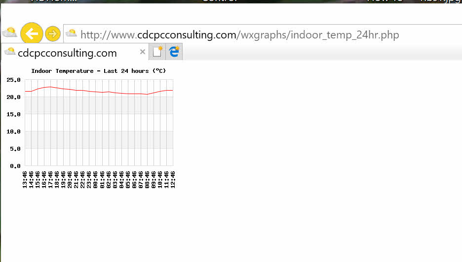

Mark, if you look back at the chart in reply #8 it appears he’s hitting a 1 GB limit :?

Niko - Mark - put line of code into script and ran it - there were no errors in the server logs and graph resolved properly.

It’s a problem with jpgraph in general, not specific to the wxgraphs. I set up a test page on Craig’s server using five of the jpgraph examples and it has the same problem :?
Niko - thank you. I also noticed that they had throttled me back since after numerous tests and attempts with high memory usage, so I think it is a pre-programmed reaction that lasts for maybe 24 hours…

Thanks Stuart. I now tried 4.0.1 on Craig’s server and it doesn’t change the problem with wxgraphs or the jpgraph examples. I don’t know what else to do :dontknow:
Yup I took a look again at his steel gauges and sure enough it’s a lottery as to which graphs pop up and which dont. There’s something very strange with the server.
Same on the test page WX Graphs test page
For whatever reason each graph is using a lot of memory, so one or two are OK, but more than that and the server can’t/won’t handle it :?
