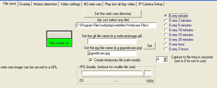

Here’s what mine shows as an example…

OK - tks for the screenshot. I have used exactly the same as yours.

OK…Mine was just an example…obviously each image is a separate file in its own right…Those images are saved to a nominated (or created) “directory” within WD…My sub directory is within WD and the Webfiles directory…If you open explorer you can see the individual image files being created within the Directory.

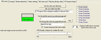

Current settings
and
Is WD creating a current jpgwebcam.jpg image in your webfiles/webcam directory? If so make sure you have also chosen that file for the WU uploads.
Also if all the above is correct and it still isn’t uploading then try and enable the file save (every minute) in Web Cam from Control panel…
OK - fingers crossed I think the image is now being uploaded.
