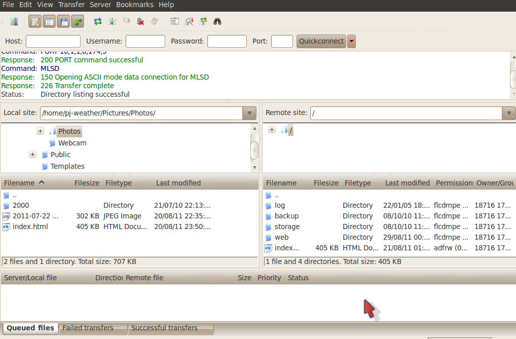

Setting up your own weather website using WD for Linux.
Warning: WD is a very powerful piece of software and can do almost anything you want it to do. However, in my opinion, it is haphazardly organised (not a criticism, just an observation) and poorly documented (this has traditionally been one of the downsides of Linux projects). This means that if you are a beginner or an intermediate in Linux, you are likely to spend a helluva lot of time just finding out how things are supposed to work - at least that was my experience. This tutorial is my attempt to be part of the solution and not part of the problem.
Here are the things I wish I knew before I started the project.
a) WD is powerful and can do what you want…if you can find out how.
b) There are far fewer commenters on these forums than you would hope - so help is not always at hand.
c) You need to set up a static file somewhere called something like image.jpg. This will be a static file and to this name, you will post your webcam shots. This static file will then be uploaded on a regular basis (set by you) to your website and to WeatherUnderground (if you so wish). You will have to point WD and WU at this file.
d) There does not seem to be a program in Linux which can take webcam pictures at regular intervals and post them to a static file name. Work arounds are required.
e) Whatever solution you come up with, it will not be elegant. HT niko :slight_smile:
  1. Get yourself a website e.g www.xxxweatherxxx.xxx
  2. You can get this from GoDaddy. I have stolen the following from various posts by niko.
Following (and stealing from Bob), Creating a basic web page FAQ
Where Bob’s FTP/Internet set up is for Windows…the attached is mine for Linux.
Follow Bob’s instructions and fill out this page. Note there are duplicate numbers on Bob’s page…focus on the blue numbers that have arrows attached…ignore the ones with no arrows.
My generation time window is shown attached…again follow Bob’s lead…but ignore again the blue numbers with no arrows.
Now you will be taken to 3 web page set up forms. As each of these posts has a maximum of only 4 attachments, I will to the next post to show my 3 forms.
Ooops! for some reason my internet set up page was not loaded above. Here it is now.
