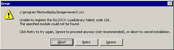

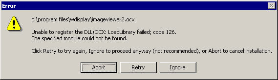

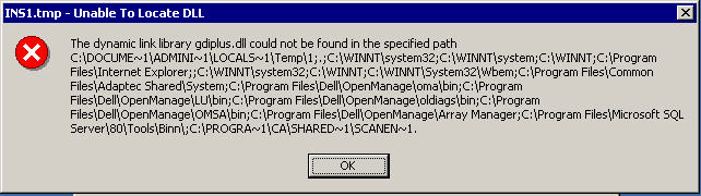

I just successfully installed and loaded WD on my Windows 2000 Advanced Server at work. This is a 4 CPU Xeon box that has all the latest MS patches and tons of security lockdowns in place. Took me 2 attempts to get it installed:
Attempt 1:
Accepted default path of c:\program files\wdisplay
got attached errors when the install attmepted to register DLL’s and complete install.
Attempt 2:
Problem looked path related so I added c:\wdisplay to my server PATH and then ran install again. This time I changed default install path to match my newly added system path c:\wdisplay. Install ran perfectly and I was then able to launch WD and start configruing it no problem. This is a work machine so I obviously don’t have a toy attached (nor can I).
Seems to me this proves that WD CAN be installed on a Windows 2000 AS MP machine!
