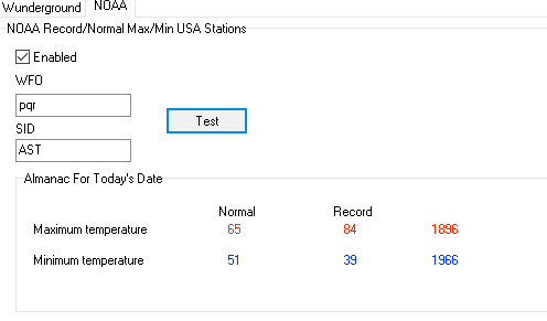

I concur with NorCal Dan, its displaying the records, but mine is for tomorrow (Tuesday’s records) and not for today. This should be a quick fix.
Thank you Brian for adding this script from beteljuice to WD.
it might depend then on the time of day that you view it
@tbrasel: I looked at the NWS Page for Dan’s parameters and I don’t see it showing values for “Today”, only Tomorrow. Maybe you could check your NWS page too?

Concur. Just checked mine and it shows:
THE ASTORIA OR CLIMATE NORMALS FOR TODAY
NORMAL RECORD YEAR
MAXIMUM TEMPERATURE (F) 65 84 1896
MINIMUM TEMPERATURE (F) 51 39 1966
This matches what WD is reporting…I will check it later this afternoon and see if the wording or numbers change…
[color=red]Add: Here’s what it shows now…
THE ASTORIA OR CLIMATE NORMALS FOR TOMORROW
NORMAL RECORD YEAR
MAXIMUM TEMPERATURE (F) 65 85 2006
MINIMUM TEMPERATURE (F) 51 41 1976[/color]
Update - today worked perfectly once the record was for only one year

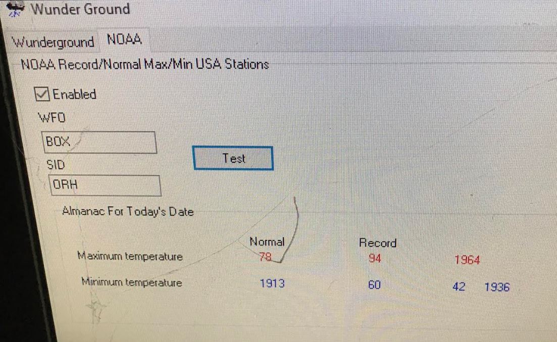

It happened again that the hi temperature is recorded on 2 separate years and it messes up low temp record as well as the norm temp. Is there any plan to scrub the second date if there is more than one year with the same recorded temp? My avg temp for today is stating 1964 degrees on my site. Seems warm 8)
This is happening a lot more than I would have thought
Thanks as otherwise it
yes, I should be able to fix that
what are you settings that you are using?
Hi Brian
Under weatherunderground almanac I have the checkbox enabled with WFO as BOX and the SID as ORH It works perfectly unless there is a record tied for 2 separate years.
You can see in the attached pic the record max temp being the same for 2 different years is messing up the fielding. I’m sure it happens also for the minimum temp but haven’t noticed it yet.
below are the values in my testtag.php that are wrong because of the tied record years:
$WUmaxtemp = ‘78.0’; // Todays average max temperature from the selected Wunderground almanac station
$WUmintemp = ‘1913.0’; // Todays average min temperature from the selected Wunderground almanac station
$WUmaxtempr = ‘94.0’; // Todays record max temperature from the selected Wunderground almanac station
$WUmintempr = ‘60.0’; // Todays record min temperature from the selected Wunderground almanac station
$WUmaxtempryr = ‘1964’; // Year that it occured
$WUmintempryr = ‘1968’; // year that it occured
From the NWS:
THE WORCESTER MA CLIMATE NORMALS FOR TOMORROW
NORMAL RECORD YEAR
MAXIMUM TEMPERATURE (F) 78 94 1964
1913
MINIMUM TEMPERATURE (F) 60 42 1936
John
just need to find the spare time
currently have 2 woofers here helping me plant my last 1000 native trees 8O
try a new .zip update re the repeated year issue
Thanks Brian. I loaded it and will let you know if I see any issues.
