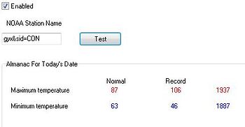

I must be doing something wrong.
I tried to add station name as CON , gyx , gyx&sid=CON
and I get the same records 102/49 all the time.
Do I need to add the script files anyplace?
Do I need to modify the advanced dashboard according to patch.html from betel’s instructions that is in his bethel_noaa script or do I leave it alone?
Link for my area
https://w2.weather.gov/climate/getclimate.php?pil=CLI&recent=yes&wfo=gyx&sid=CON
Thanks for any help

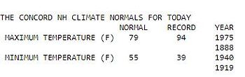

I am using the new function, But the values are not correct when I use the test button.
See attached for test and normals
Not sure what I have done wrong.

yes, what you have entered as station name is not correct windgust
I had a default one entered (oax)
and so it needs to be like that format
as Niko has pointed out
I’ve looked at it some more Brian and I don’t see how this can work as it is :? As I read the original script you need to select both the office (wfo) and station ID (sid), but the WD page only has the one value pre-populated as “oax” which is the Omaha Valley Nebraska forecast office ID (wfo) . The data shown on the WD page appears to be for Lincoln, sid LNK, so I’m guessing that’s hard coded somewhere.
ah
your right
I need to make it where you can set the other parameter needed
will do that

Maybe this was intended but WD is getting the record hi/lo values for tomorrow–not today’s records. Today’s records are further up the page.
