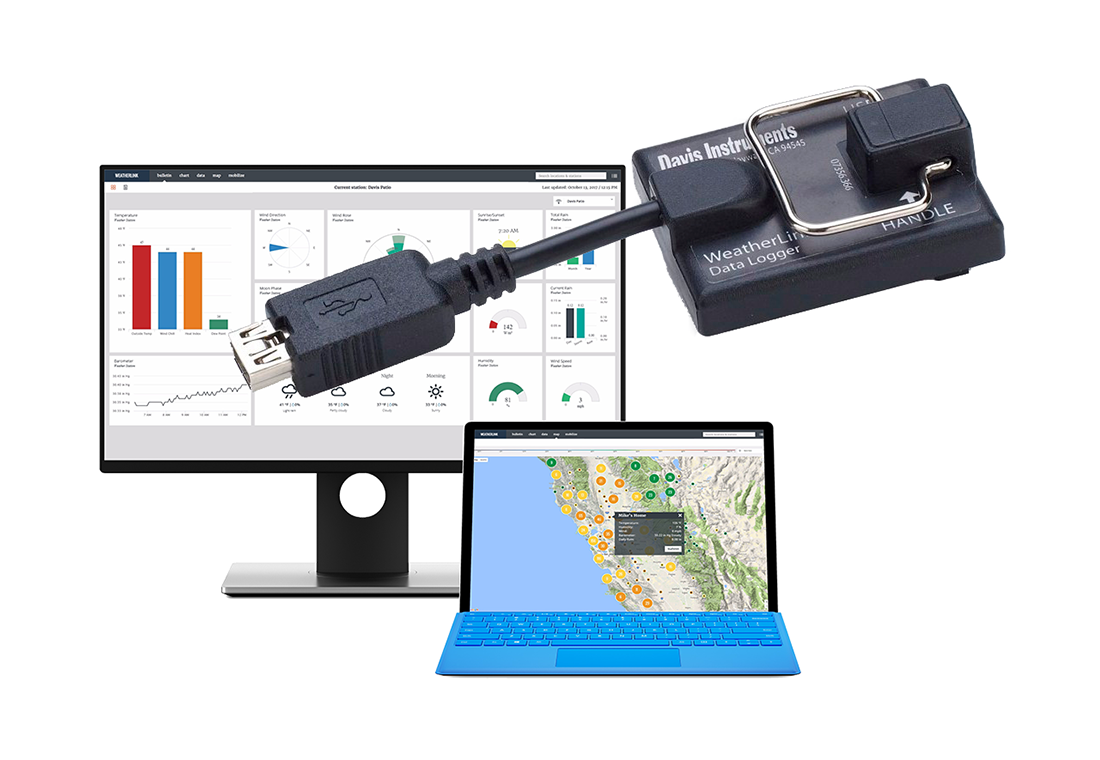

I’m looking to get a new Davis 6263 to replace my old unit from 2007.
The new unit has the 6313 console but If I’m not mistaken this unit does not have a way to connect to my PC like my old console did.
What is the best way to get my data into Weather Display? Do I need additional hardware?
Someone recommended the 6100 and reading up on it a little and I’m not sure if it will work.
With the local API can you pull live data? My current setup pulls data every 5 seconds. Can it do this?
If I loose power does it log the data? If I use the local API when power is restored does it pull from the logger or only live data?

Not sure what model your 2007 hardware is, but if you already have the Vue/VP2 console and datalogger I would think they will work with the 6263. Shoot Davis an email to confirm…
Yes the WLL will continue to log data as long as the batteries (or UPS) lasts, or it runs out of memory - a couple of months iirc.
No you cannot access that buffered data locally. The WLL will upload it weatherlink.com when the power and internet is restored. You can download it from there if you have a paid subscription.

After minimal research the 6263 is a VP2+ but this specific “package” comes with the 6313 console instead of the “normal” VP/Vue console. Does your 2007 equipment have a VP2/Vue console and datalogger?
Yes, my old unit has a VP2 console and serial data logger.
That should work with the 6263. I don’t see anything “new” about the 6263 other than they replaced the standard VP2 console with the 6313 console. If you don’t want/need the 6313 console then I would suggest getting a standard VP2/VP2+ and continue to use your console/datalogger.
