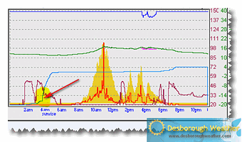

I know this to be the case looking at some of the previous graphs… I have added a graph below to
show you what i mean, you will see what a multiple tip looks like, (see arrow) you can see the difference
between a single tip which is a smooth ascent of the rain line but where the arrow is theres a vertical
climb, this is telling me there was a multiple tip for that transmit as it jumped more than normal
Am i making any sense lol?
Err, yes.
Yes.
There is no doubt at all that the sensor can handle multiple tips in a transmit cycle.
The question is how many it can cope with in a transmit cycle (on the assumption that it takes the gauge a finite time to process a tip and recover itself ready to process the next one).
