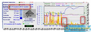

We have had a little heavier than normal rain today and thought i would share
as some thought the modification might not handle anything other than normal rain.
Well today it looks like ti handled it quite well, you can see this in the graph, i aint
had any errors from the rain gauge on the console as yet, in one part it went from
6.7mm to 8.0mm in one foul swoop lol so it looks like the gauge records the tips and
stores it untill its sent to the PC at the next interval, i didnt know this i assumed it just
sent 1 tip at a time but evidently not
Anyway, heres the graph from today, still raining btw
WD recordng multiple tips in a minute shouldn’t be a problem and 3 tips in a minute sounds not unreasonable for the gauge to handle, the ‘worry’ is that with 0.1mm sensitivity tip quantities might arrive so rapidly that the sensor itself doesn’t record them (either because the electronics might require a finite time to process a tip and reset, or because the bucket mechanism it self couldn’t work fast enough not to spill some water unmeasured).
The only way to be sure would be to have an alternative gauge for comparison - but the alternative gauge would of course need to be quite sensitive itself to notice the odd few 0.1mm of rain going missing! :lol:
