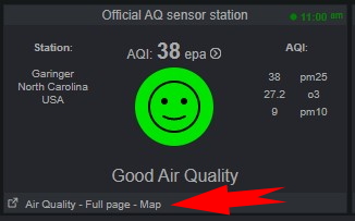

Map Feature in Air Quality
I have noticed a new map feature in the Air Quality block. It does not seem to be working for me or on several other sites.
Where do we correct this?
Same here, good spot.
turn on extra links in other tab
Extra links is already on, but good thought.
BTW, the map link is not working on your site ‘N.E. Calgary, AB Home Weather Station (wd version)’ either.
weird, i just opened the map about 30 minutes ago
I just tried again. Works fine at my end
Luftdaten map does, Official map doesn’t. And “Full page” shows Belgium. . .
I thought it might be a browser issue but your map is not working for me on IE, Edge or Chrome.
Really weird it is working for you and not me.
I managed to get the full page fixed, but having an issue getting the official map fixed

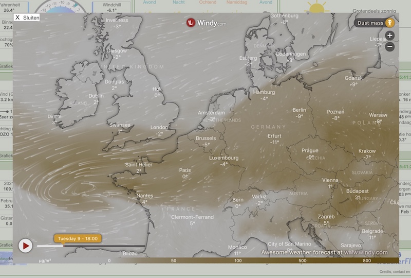

===another solution
https://www.mytempestuk.com/pwsWD/fct_windy_popup.php?lang=en-uk&script=temp_c_block.php
Go to the select menu at the top right.
They have also a “Dust mass” layer we could use.
Thanks Wim,
Yes I’m familiar with Windy, and upload data to them separately. That’s a good idea, and maintains consistency with other parts of the template.
Attached two adapted scripts to show the windy map for PM/dust
Please FIRST make a backup of the current two scripts on your server.
aq-map test.zip (6.04 KB)
Thanks Wim. It’s a pity they don’t show PM concentrations in that version, like they do in the app.
It should show it. I aatach a modified one which will show a marker with the value, you can drag it over the map.
What is the link to your dashboard site?
This one https://www.mytempestuk.com/pwsWD/ has only the old link.
fct_windy_popup.php.zip (2.68 KB)
Sorry I had made some changes to the image_popup.php that I needed to add to the test script before installing it. I’ve installed it now and it still doesn’t show the Windy map. It still hangs like before.
https://www.mytempestuk.com/pwsWD/index.php
Sorry to nag Wim, but this new Windy map still doesn’t work.
