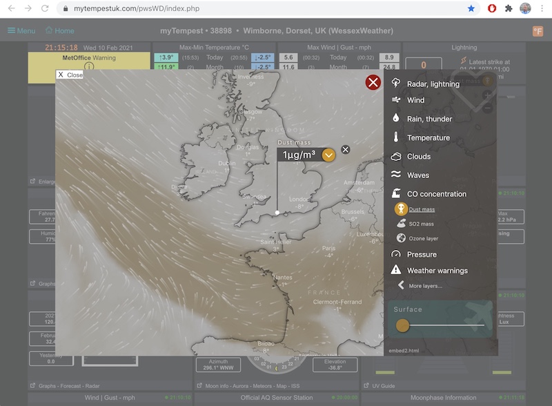

It’s working now, although I can’t seem to show PM2.5 and other air quality parameters, which are apparently only available in the full Windy app.
You can click on the map it shows the value for the “dust” at that location.
At the menu on the right you can select between the pollutants CO PM(Dust) SO2 O3
You can also get the forecast for the pollutants (at the bottom), but then the visible area is IMHO to small

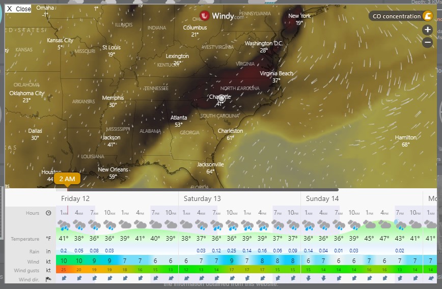

I had to use the show-frame line in a previous post. Also removed the ‘iframe’…‘/iframe’ from the url generated by the builder.
Finally added the spot forecast and it looks and acts like every other Windy map in the template.

The full “stand-alone” version https://www.windy.com/ has both a “pm2.5” and a “Dust” layer.
For the PWS_dashboard:
I tested windy from the menu (full page iFrame) and as popup (smaller iFrame).
The embed script Windy: Wind map & weather forecast has no (new) pm2.5 layer (yet ?).
We therefor still need to use the “Dust” layer. It displays the pm2.5 value for the selected location.

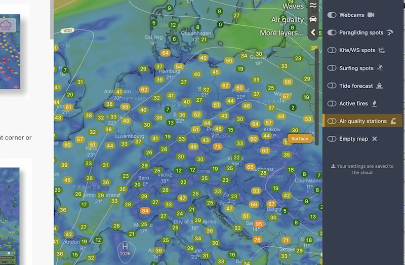

Sadly that windy link shows the full (stand-alone) version.
There you can add “show stations” which show the measurement directly, see attached screenshot.
The embed version does not allow you to specify the values on the map. It seems to be only temperatures.
To use other layers values and other features you need the paid for version which starts at 990€ / year.
In the embed version only the flag will show the “dust” (=pm2.5) values. Or the wind-value if you selected wind.
