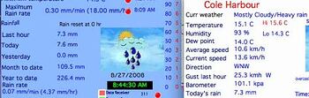

OK it’s daytime (and raining again), and I think Solar is working with one exception.
The icon is not allowing over ride when raining. Instead it is mixing the solar and the rain so I get today “Mostly_Cloudy/Heavy_rain”

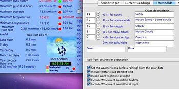

Here are the screen dumps. Note that I have the settings all done as per KTrue’s tip on solar icon settings.
The icon is not allowing over ride when raining. Instead it is mixing the solar and the rain so I get today "Mostly_Cloudy/Heavy_rain"
ideal :slight_smile:

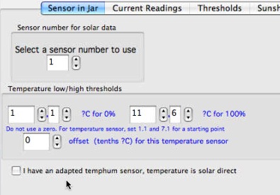

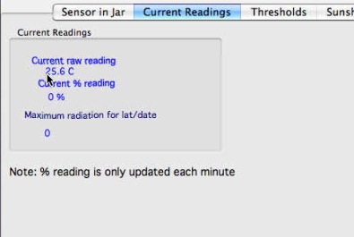

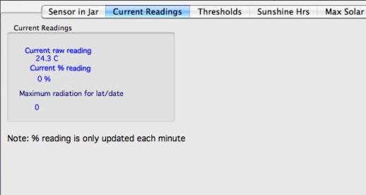

OK, I looked at my icon and noticed that it was showing overcast and solar at 0% on the graph, but 50% in the black box… when it was sunny… so I went to the Solar raw reading and took a screen dump for you showing it wasn’t calculating percentage.
I restarted WD Mac and waited a couple minutes and the solar % came back to the grapha and the icon changed to sunny. I took another screen dump (see pic 2 )and changed no settings.

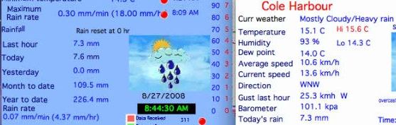

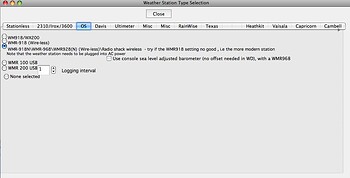

But a few moments later the same thing happened, solar graph went to 0%, the black box said 50%, and the raw reading said 0%, but the temp is about the same. (See pic 3)

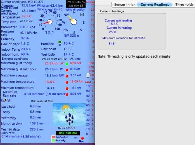

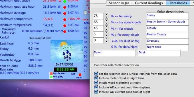

Outside temp is 19.3 and pic 4 is my solar setting. Still very sunny.
