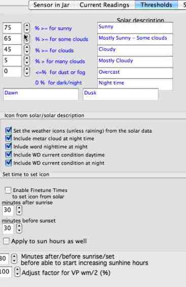

OK the scoop is that this is the only extra temp sensor I own. It is in the temp 1 position (extra) on the console, and registers as extra temp 4 in WD Mac. But the selectors in that tab only go to 3… so I can’t select it as a sensor for the solar. (My head hurts now lol)
I will post the screen shots again but they haven’t changed from above. Here goes:
and this last one:
Jim, Looking at your settings, everything looks ok except for screen 1. uncheck ‘i have an adapted temphum sensor.’ I believe that this setting is for a MODIFIED temperature sensor, and not for a solar in a jar sensor.
