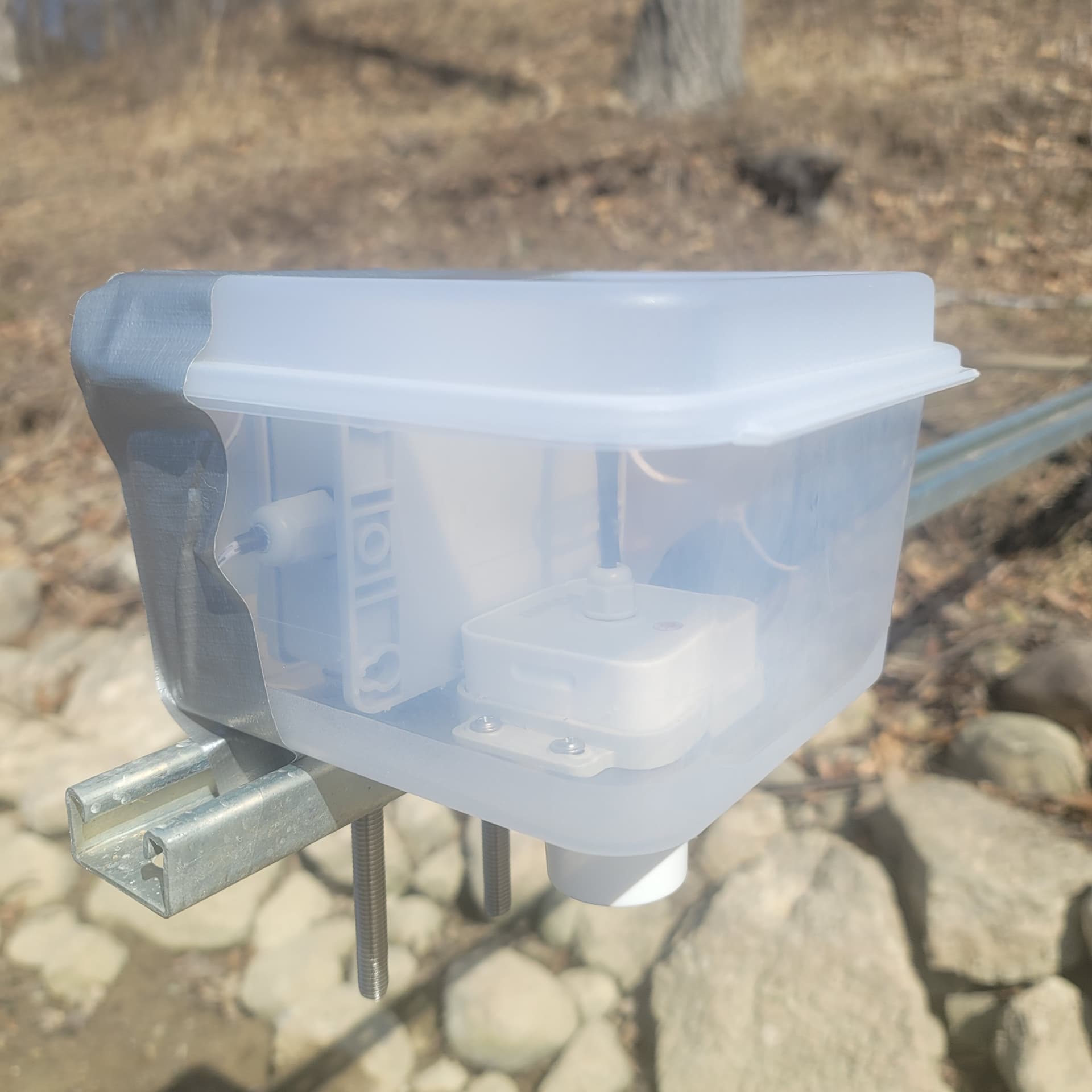

I’ve attached a couple of pics. One show my “temporary” siting for the LDS01. Basically a Sterling wallyworld plastic box. My LDS01 is down at the lake and I’m getting 4 bars signal strength. It’s about 100’ downhill from the house. My GW2000B is in the basement so I’m going thru 1@ 8" block wall. For anyone curious.
